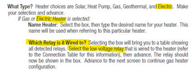

I already have a Omnihub controller, and a MaxFlo VS 500 omni pump for this build. Are there limitations to the type of heater that the omnihub can control? the manual hasn't been super helpful for me to understand, I saw that it has either 2 or 3 wire external control for heaters.

The Omni uses the low-voltage 24V, that most heaters use as control circuits, when it controls a heater. The wiring diagram for neither the Hayward nor HydroQuip shows a low voltage circuit (no transformer).

Connect the electric heater through a low voltage relay on the OmniHub.
Since the electric heaters you are choosing do not have a low voltage control you need to use a transformer and contactor wired to the OmniHub low voltage relay.
You connect the high voltage of the heater to the contactor.
Essentially you are using a low voltage relay to control a second high voltage relay, the contactor.
