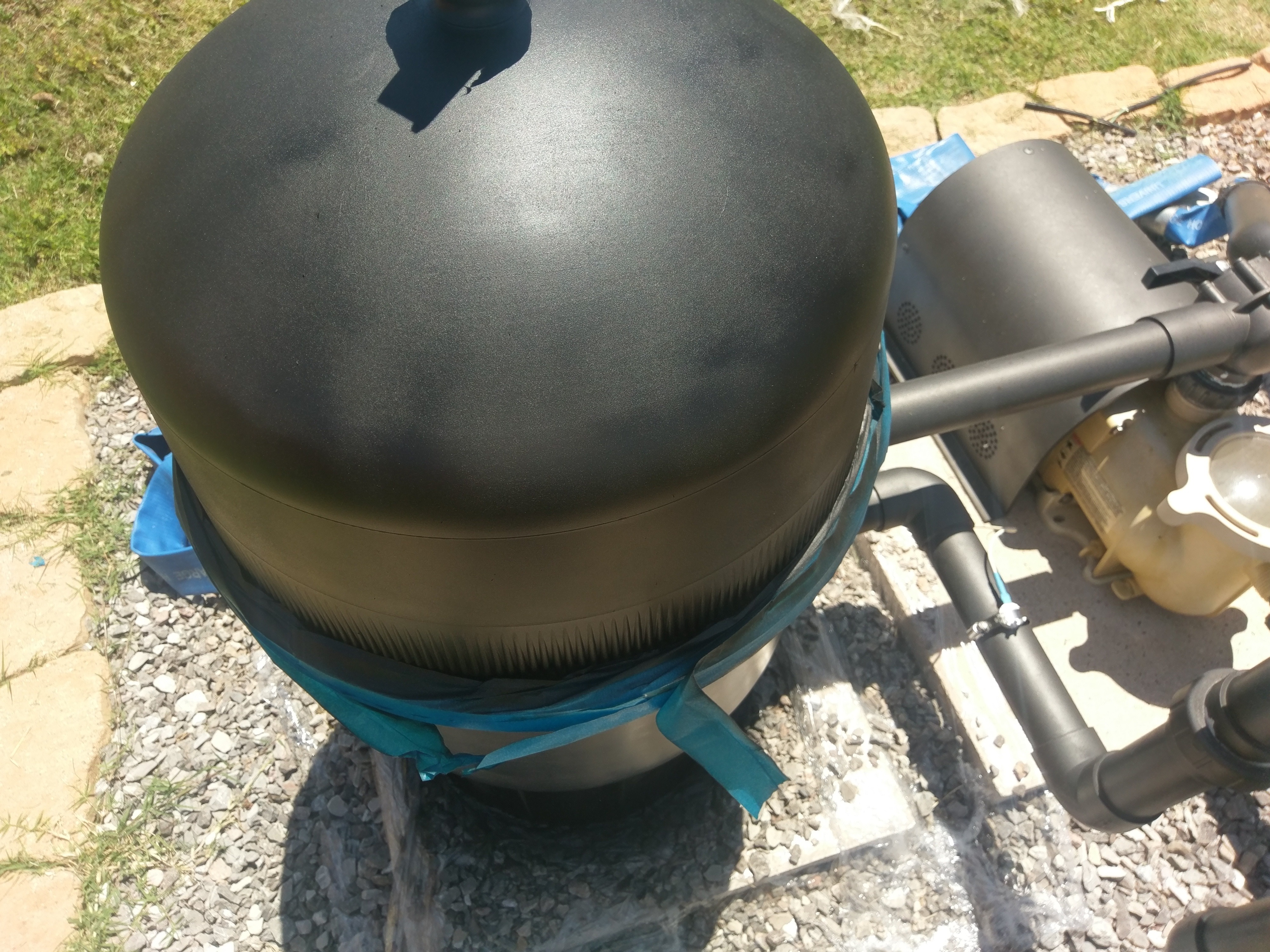

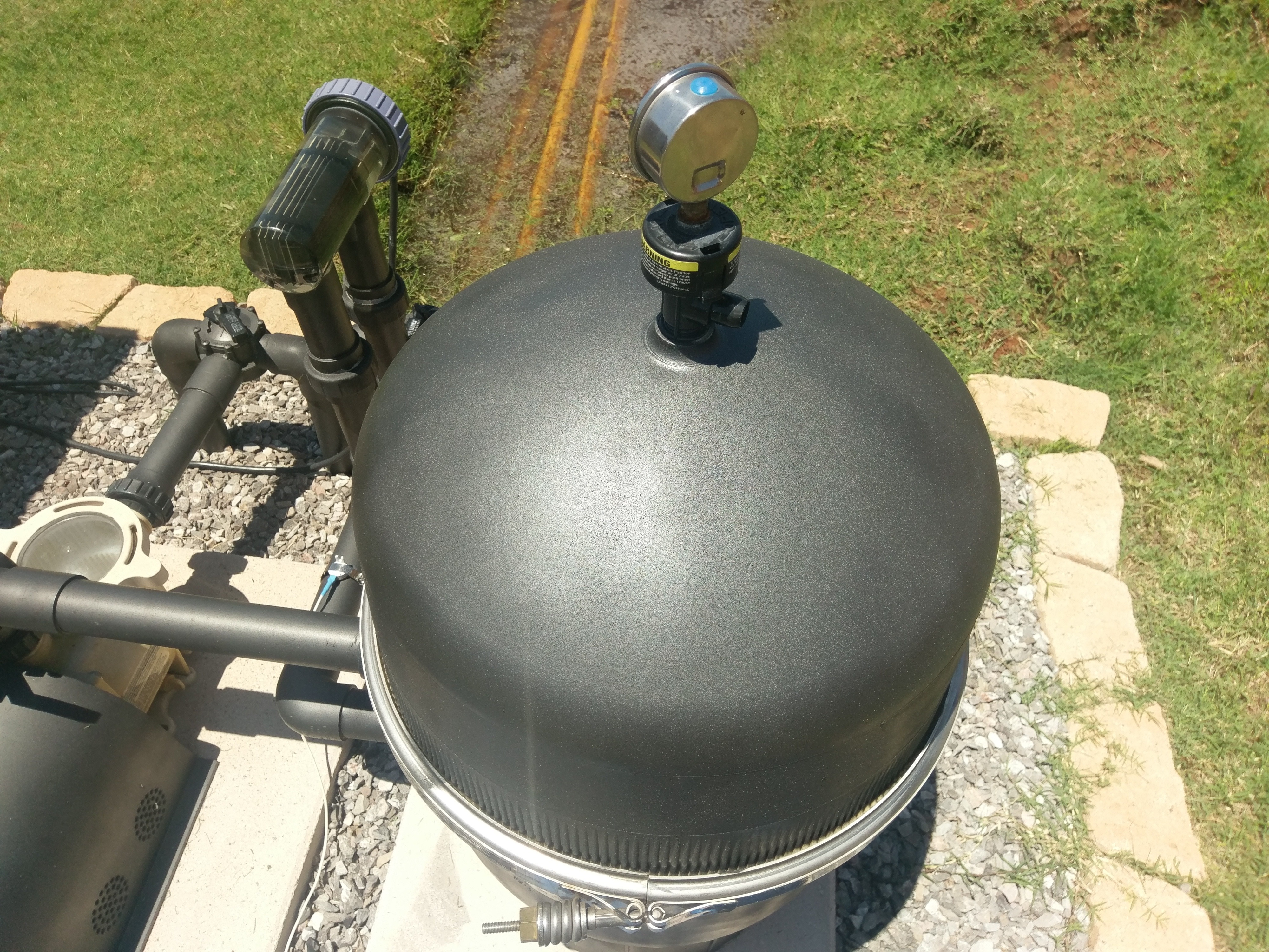

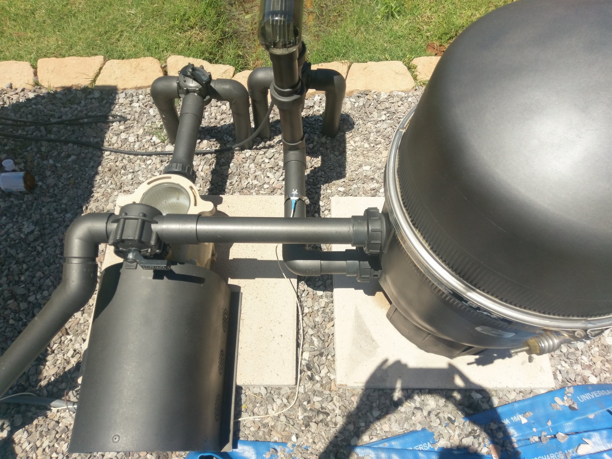

You can use any pump and filter on any pool.. are they made for intex, no... they are made for normal pools and intex is made in china and does not have normal connections... The funny part right now is intex is built and made cheap to be bought cheap but there pumps and filters are just as expensive as normal pump's and filters right now... :)
filter
Here is a 2 speed pump you can run on low 95% of the time :)
swg, these will last 5 to 7 years but you pay for the chlorine up front..
for all these you will have to run hard pipe as I did :)
Welcome to TFP :)
filter

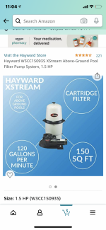

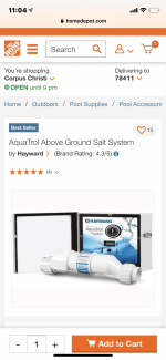

Here what I pick , I would like to get your opinion on that😊Do you think it’s a good choice for my Intex of pool? Will it all be connected without problem?
Hayward W3CC15093S XStream Full-Flo Element Filter System, 150 sq ft with 1.5 HP Matrix Pump

Hayward AquaTrol Above Ground Salt System

Those should work just fine...
I am not sure on that pump if they will work so you may need to have the pump ordered and measure..
these worked on my pump..
these will connect to the skimmer and the 3 through wall connections below, you will need 4.. (these may also work on your pump, not sure)
use these to convert to 1.5 inch hard pipe through wall on the 3 holes for the intex returns..
then just run your hard pipe.. this will give you 2 returns and 1 skimmer and 1 suction side vacuum port.. You can have a suction side cleaner or just the normal vaccum..
I also used 3 way valves, 1 on my returns and 1 on the suction side...

Yesterday, I ordered this one - Hayward W3CC15093S XStream Full-Flo Element Filter System, 150 sq ft with 1.5 HP Matrix Pump. Do you think isn't its too powerful for the size of my pool? 18x52 Intex round. :giggle:
I'm not the best person to ask since I'm currently using Intex filters, but no...I think that will do a great job for your 18'! They always say overkill is better than not having enough.
