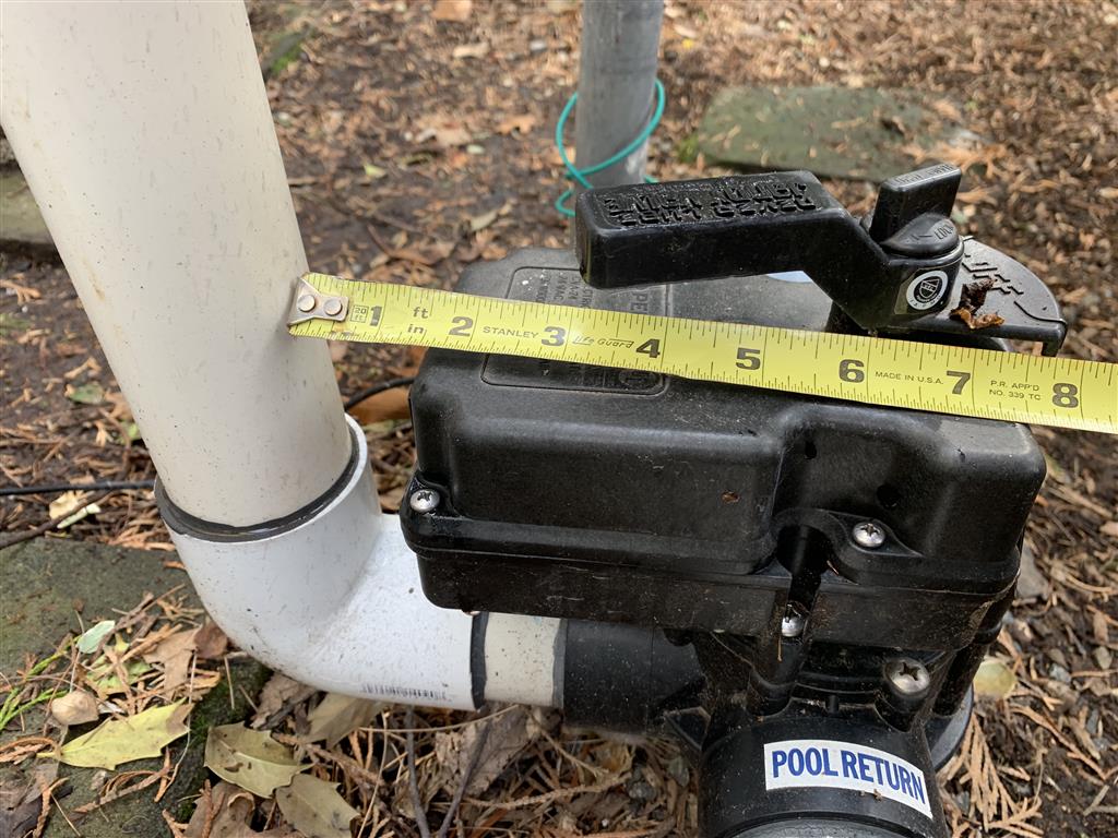

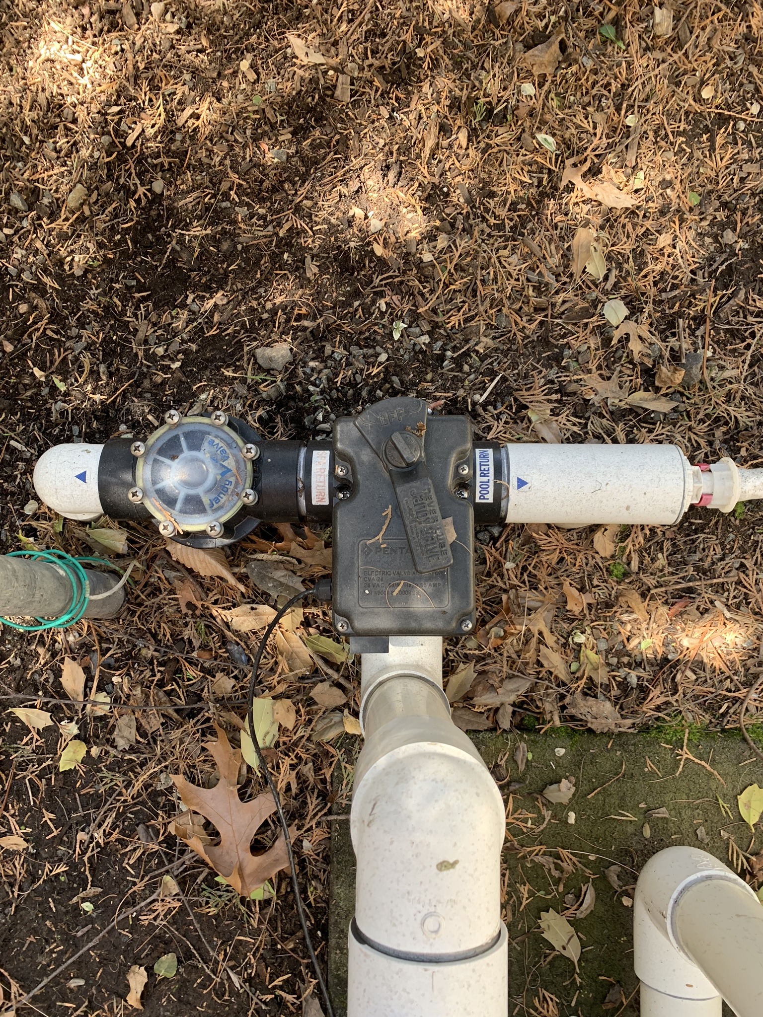

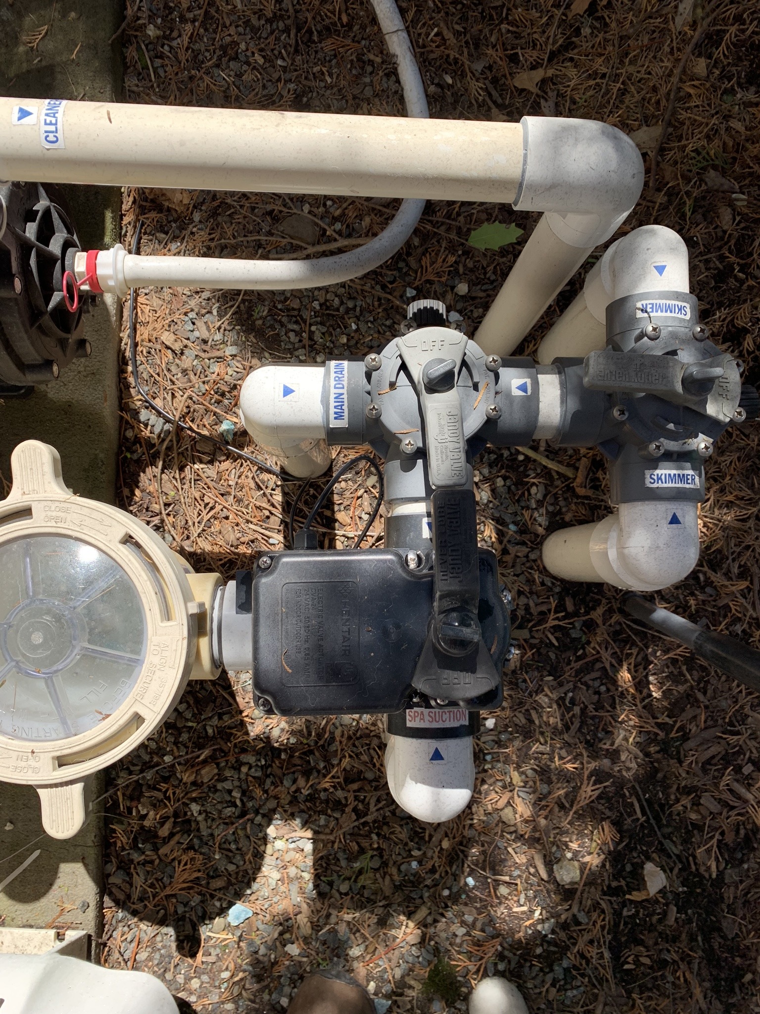

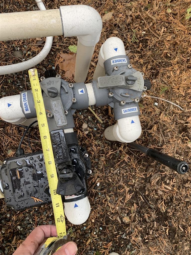

Rob, I saw that about your valve problems. I sort of understand the problem. I did not intend to make any plumbing or valve changes. Below is my actuator setup. Does it look like Intellivalves will be a problem?
Allen,
1. I don't think it will be a problem with the Return Valve - Pool/Spa. But that vertical is close. If you want to give me a measurement from center mass of the valve housing to the edge of the vertical pipe, I will measure it for you and let you know.
2. Same with the suction valve nearest the pump. Measure center mass of the valve housing to the edge of the pump basket lid.
3. Give me a measurement (center mass) from the valve that is labeled "MAIN DRAIN" and the one labled SPA SUCTION.
4. And the same from the valve labeled "MAIN DRAIN" to the "SKIMMER" valve.
If you give me those measurements, I'll use my IntelliValves and see if you will be okay.

Rob, pics with measurements are below.
I could take the two existing Pentair actuators and move them to the Main Drain valve and Skimmer valve, if they fit. I am not sure they will fit and I am not going to move pipes around for that. I can figure that out at installation time.
Will the Intellivalves have any problem fitting where the two existing actuators are?
Thanks for your help.

Yes, you could use your two existing Pentair actuators if they fit. Just remember, that they will have degraded capability compared to the IntelliValve's capabilities, when the anticipated update is released.
Installing an IntelliValve at that 3-way just prior to the pump will be close. You will need a minimum of 5.5 " from center mass of the valve housing to the end of the IntelliValve (including about 1/4" to bend the cable around. Same with the Pool/Spa actuator. Very close.

Thanks for the picture. I think they will fit as is. Since I will be replacing the pump with an Intelliflow I can move the pump back a bit to ensure the Intellivalve fits.
I laugh at your description of “degraded capabilities” for using the Pentair actuators. I hardly know why I will automate those valves at all let alone why I would need the advanced capabilities on those two.

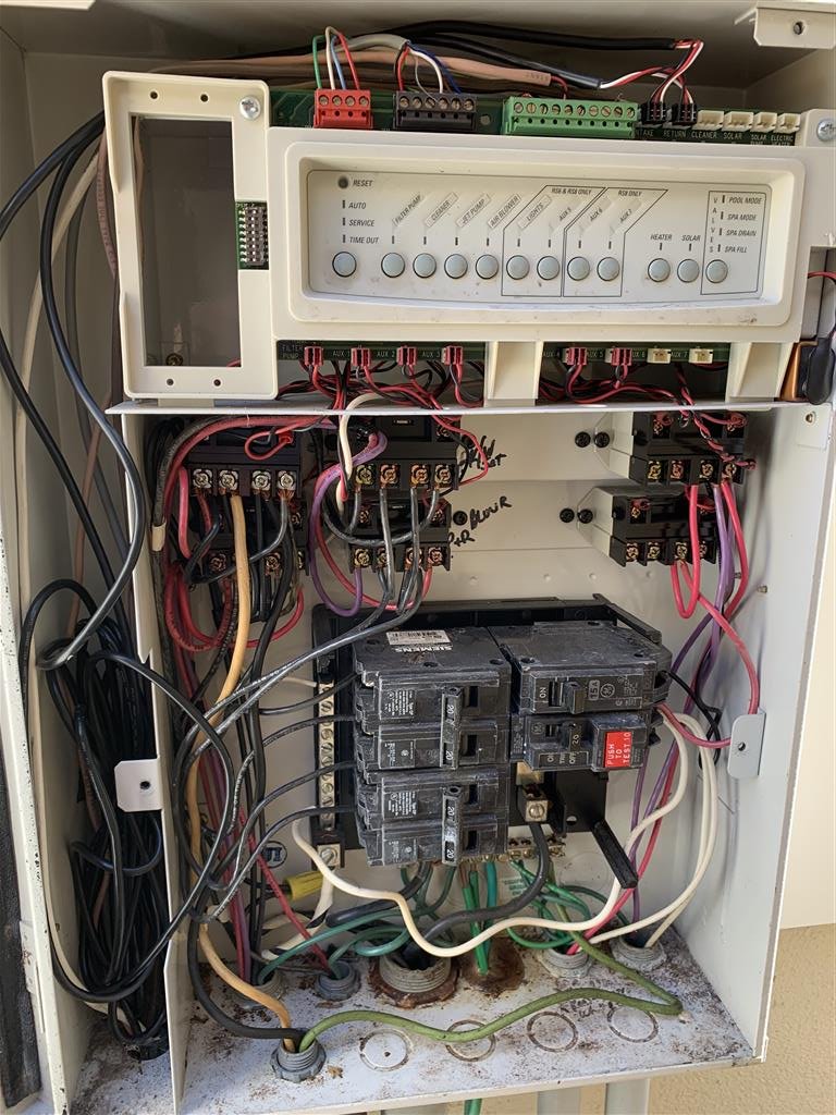

I finally got around to wiring up the CBs in my IntelliCenter. It is replacing a 20 year old Aqualink panel.
I plan to lift off the Aqualink panel and drop in the IntelliCenter panel and wire the equipment to the new relays.
Below is the wiring I have done. I always like QC checks and if @Jimrahbe @MyAZPool and others can let me know if I messed up any wiring.
Pic of old Aqualink Panel...

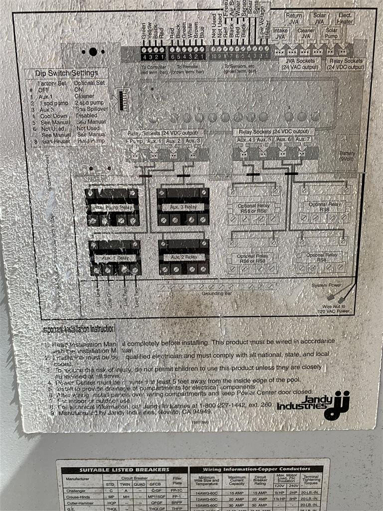

I assume that the IntelliCenter system transformer is supposed to be wired for 120 VAC. Using the EasyTouch manual it is wired for 220 VAC. The IntelliCenter may be different, but please double check before you power it up.
The SWCG transformer is correct.
Jim R.
Allen,
My EasyTouch's manual shows how to wire both the SWCG and System transformers for 120 or 240 volts.. I don't see that in the IntelliCenter manual. Maybe I'm just not looking in the right one.
In any case, I doubt that you are wrong, but it is better to be safe than sorry.
Just for my future use, please send me a good pic of the diagram on the inside of the cabinet door..
I found a different IntelliCenter manual and it shows the system transformer as Black is hot, Violet is Neutral and Yellow is capped off, just like the EasyTouch.
Jim R.
Jim Saves the day. Have to swap yellow and violet on IC transformer.

Thanks for the pics.. I thought it would have been stupid of Pentair to use a different wiring diagram for the IntelliCenter. But then again, it is Pentair. :mrgreen:
Glad you caught it early. :goodjob:

I think I had just hooked up the SWG to the relay which uses the yellow wire for 240V and still had yellow on my mind.
That’s why I double and triple check my work.
