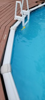

FC: 8.5
CC: 0.5
Filter ran all night with no issues and no return pressure drop. Filter pressure was 16 on arrival and was 13 when i left at 6pm yesterday. Hopefully woll start seeing water clear up soon. CYA testing due after work. I have a feeling its still low. Low CC but FC dropping stopping randomly. Yesterday was quite warm and sunny with high UV index.
