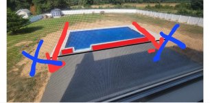

The solution for the pool side remains to be seen, If one exists. I went outside before with the deck drains posted above in mind, and because of the stairs ( which have been my kryptonite at every stage ) the drain would have to be set about 6 feet from the pool. It would solve some of the runoff but still leave a good amount if it. The blue line isn't to scale, it's drawn for example.
Now I am curious.. why?
Because the blue line is the high spot (give or take) and the drain would have to zig zag around the stairs. Pitching that through the zigs might work, or it might create a new pitch issue.
And anesthetics. Lol.
Ah, I see. I was envisioning just running it before the coping of the first step on the stairs, and then parallel with the pool across. It should be like 3' or so behind the pool (or however much your steps stick out into the patio. Getting the drain to slope one direction would be tough with where your high spot is, so yeah that might be an issue. Can you open the drain on both ends to drain off either side of the patio?
Here's what I was thinking. Run the channel drain where the black line is, draining off to either side. Then, build up the red areas to slope back away from the pool and back to the channel drain.
That's what I scoped out in my head. The black line is about 6 ft back from the pool and raising the pool edge enough then messes up the coping height of the sides of the pool, which would then need to be tapered also.
The sides currently slope down to meet the patio at the blue X's, so solving one issue creates another.
Yeah that's going to be tough. I'm interested to see what the concrete guy recommends.
