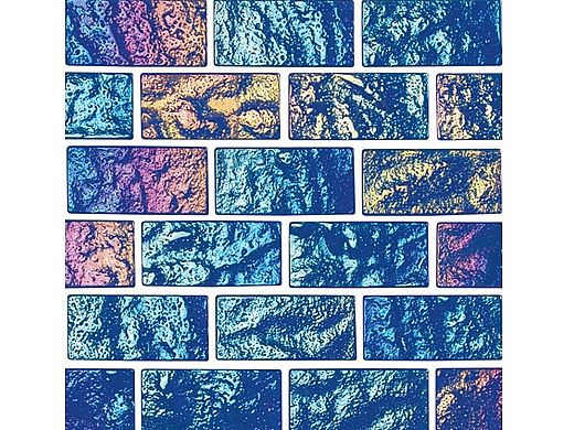

NPT Lightwaves Blue

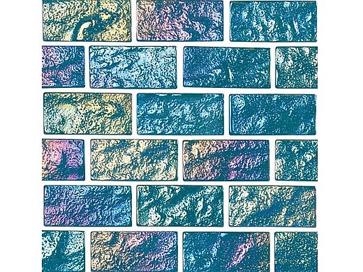

NPT Lightwaves Aquamarine
I don't think those Lighwaves sample photos show how pretty they are IRL. The Mastertile glass tiles are a bit less iridescent and a bit more translucent. I'm not sure which I'm leaning toward. I just want it to play off of the ocean in the distance, and the NPT blue may have too much purple and the aquamarine may have too much yellow/green.... but of course it's all dependent on the angle you see it from.
Are there any special issues with the heavily iridescent tile finish? I'm not sure my husband loves that look, but I love how it sparkles under water!

Okay colors:
I LOVE, LOVE, LOVE the middle ones. I also LOVE the other two................BUT if you are wanting to play the ocean's colors then the top one is it. The purple in the middle one puts it in last place :( LOL The greens in the bottom one puts it in 2nd place as some water does have a green hue at time. The top one come the closest to true ocean color to me AND it is oh so pretty and BLINGY!!!
