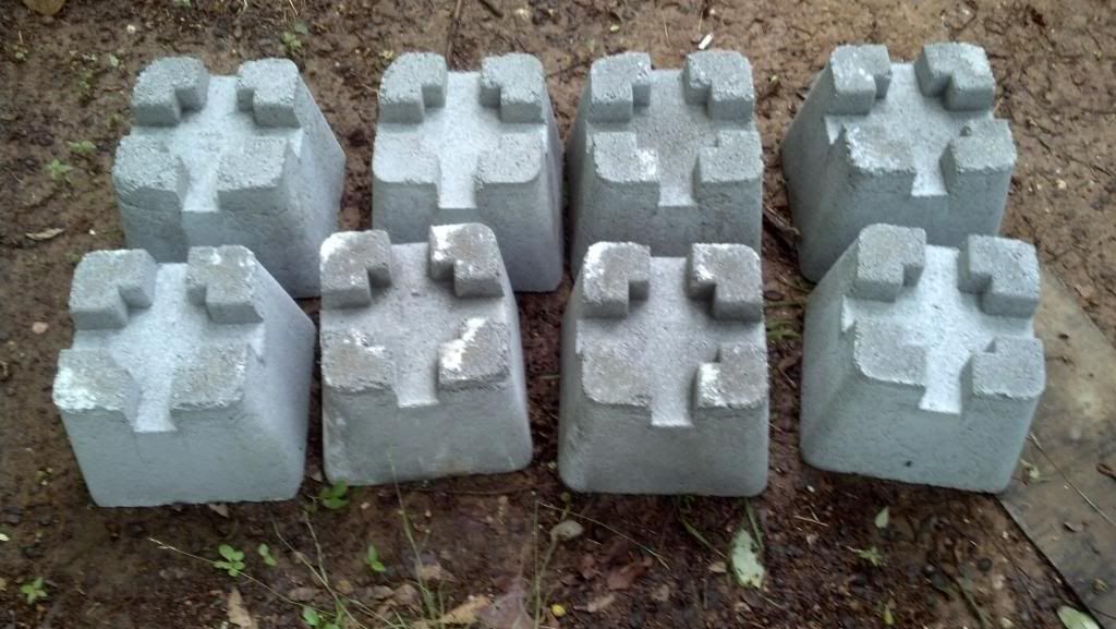

And a few deck pier blocks.
Hopefully the weather will be nice in the morning to get started putting this puzzle together. My best helper, ProfessorDaisy, sprained her right rotator cuff last weekend, so I won't have as much help as I am used to.

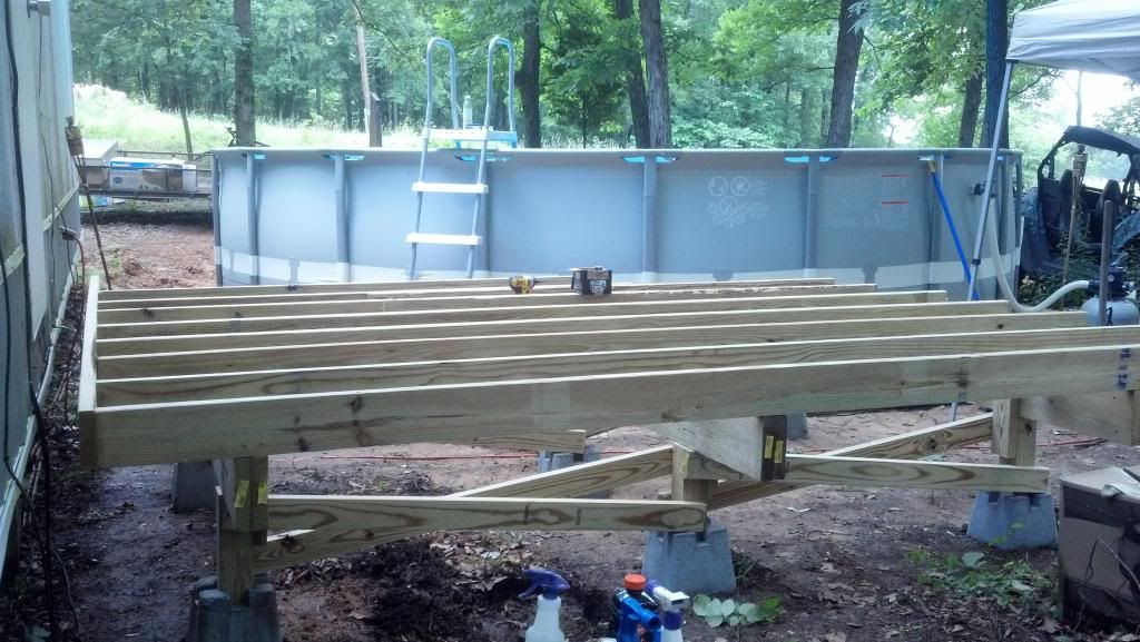

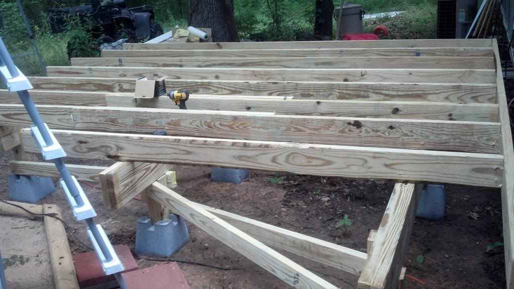

I'm trying to get caught up. I've been outside all day, but I have the first stage of our deck built. I have a couple more things to do to get it finished up, but I'd say it is 75% complete. Still have to put rails up, stairs, and a riser to get closer to the lip of the pool.
I used the same system Duckcmmndr used on his deck. Pier blocks, 2X8 beams, 2X6 joists and 5/4 X 6 decking.

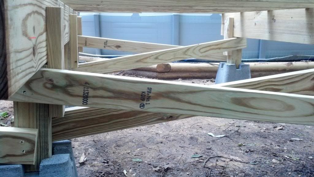

I cross braced the fool out of this deck. It doesn't even think about wiggling.
DANG IT! Just noticed my finger was covering part of the lens(TWICE!!!). Shoot!

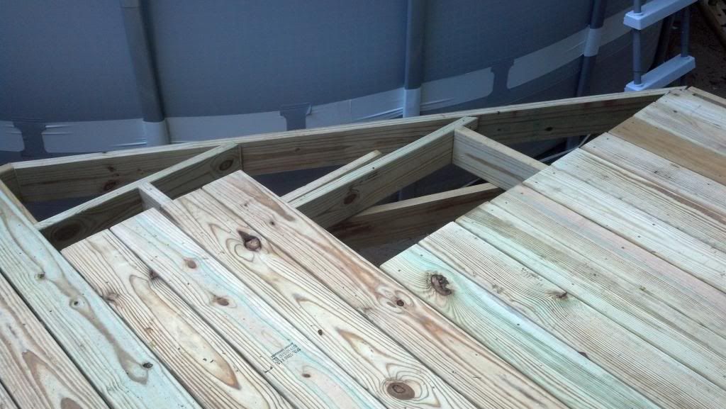

The mock up I did on graph paper had the pool in the wrong spot, so I had to improvise a bit to get the whole deck built today. The area here that the decking doesn't cover will be under the riser going up to the pool ladder so I'm not worried about filling it in the rest of the way.

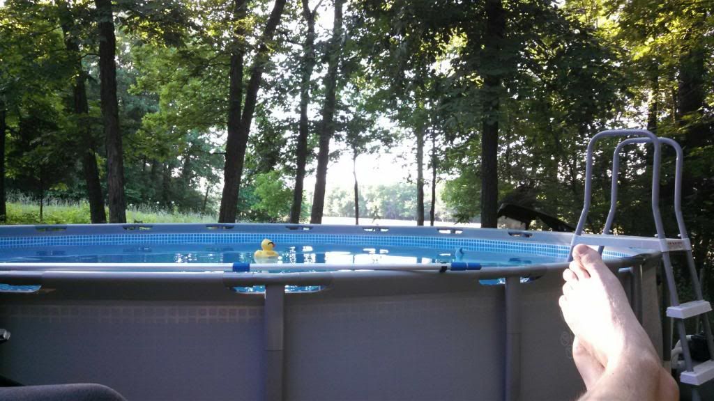

View from the zero gravity chair on the deck...
Well deserved Shiner Ruby Redbird...
