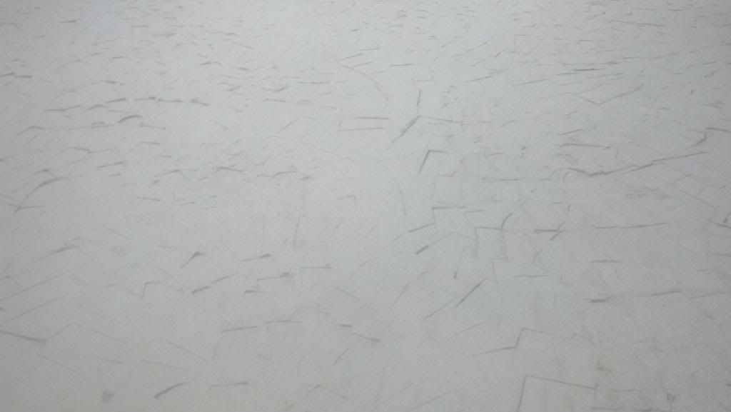

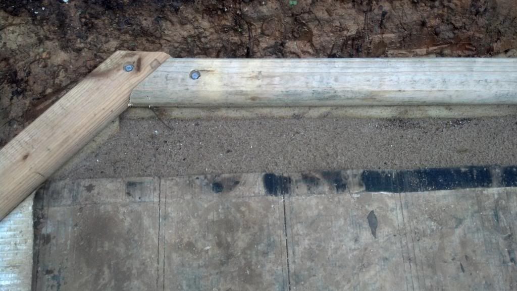

Went home with a tamper Wednesday after work and the sand just poofed out around it. We had a family dinner to attend that night so I decided to wait. Last night, we got about an inch of rain that packed the sand down nicely. No tamping needed now!
Here's a picture of the area I tried tamping after the big rain last week. As you can see, it was nicely packed. The tamper really just smoothed the sand out.

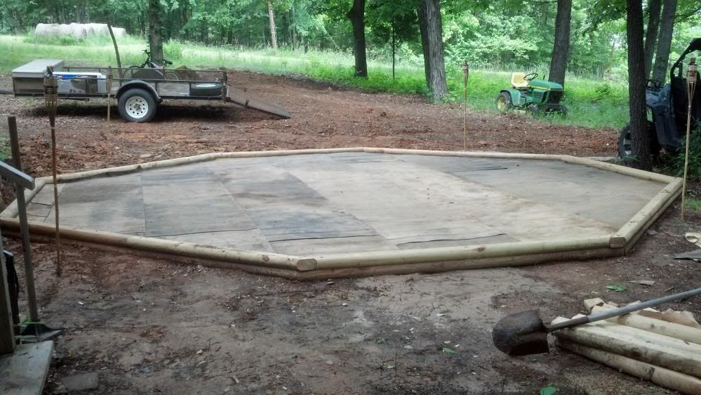

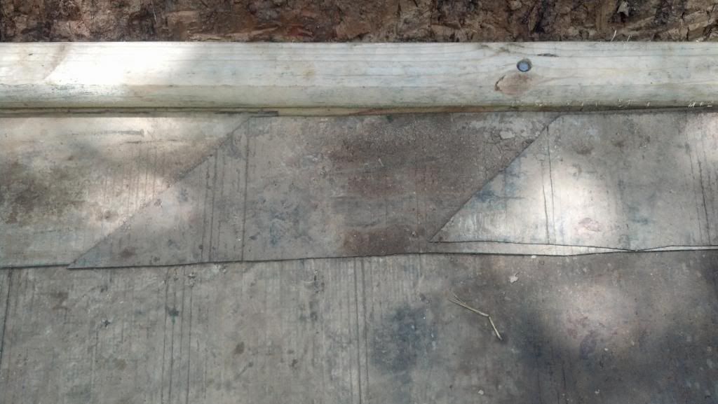

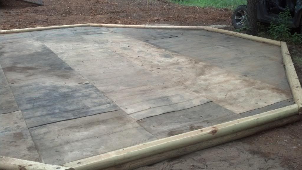

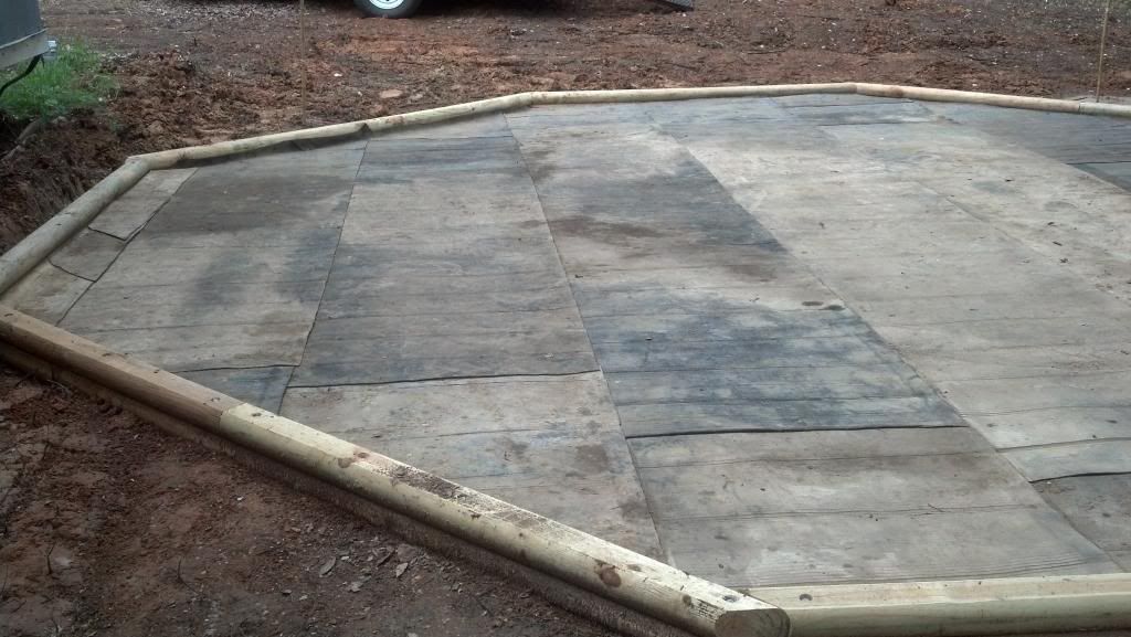

We got outside this morning and rolled out the roofing material we are using for weed barrier.
Almost ran out of the roofing from last years pool but with some creative cutting, I was able to save my new pallet of roofing for other projects. Now for another couple of yards of sand, place the pavers and set up the pool!

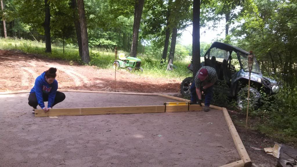

The sand finally dried enough to do a final leveling, we chose to use the 2 X 6 method. I cut 1 foot off the end of a 12 footer and drilled a pivot hole to create a 10 foot radius. I drilled a hole in the center of the 1 foot piece and drove a bridge spike through it for our pivot. I couldn't drive a stake into the ground like most do because of the rolled roofing/weed barrier we put down.
I enlisted our daughter to hold the pivot in place while I made somewhere around 642,391 circles before we finally decided it was good enough.

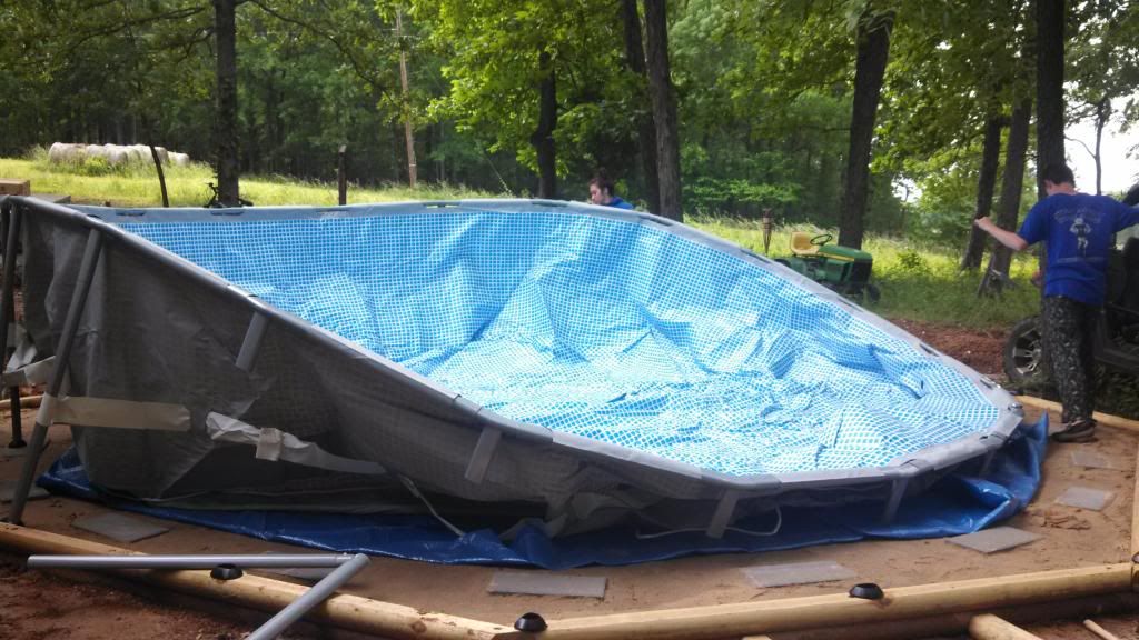

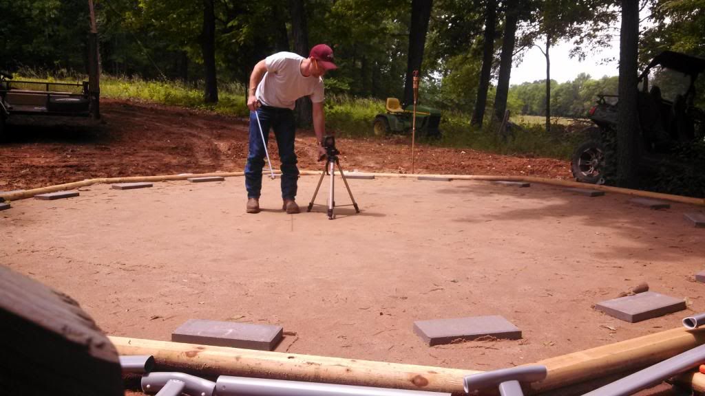

Then we assembled the top frame to decide where to place the pavers.
We used a laser level to determine which paver was already the lowest and worked our way around lowering and leveling each paver.
We had all hands on deck while spreading out the ground cover and liner, and assembling the top frame in the liner so there are no pictures of those steps.
Installing the legs.

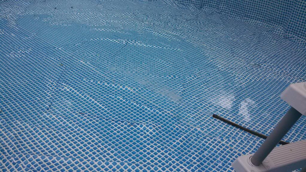

Water going in. Wrinkles are giving us fits. Some of them may just have to stay. It seems the hardest ones are where the liner was folded. Stopped the water before bed last night at about 8" in the hopes we can work a few of them out this morning before continuing the fill.

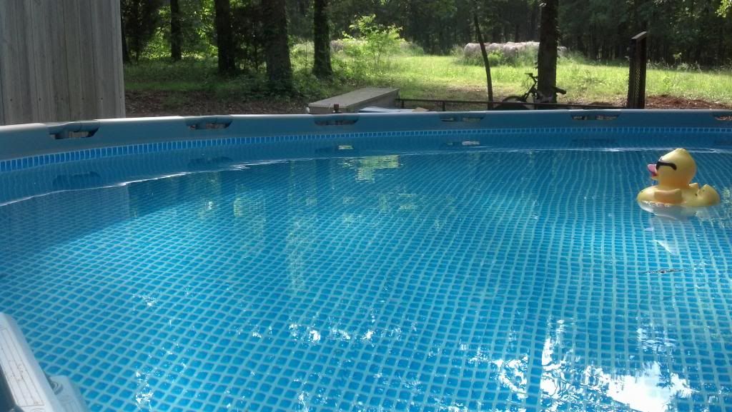

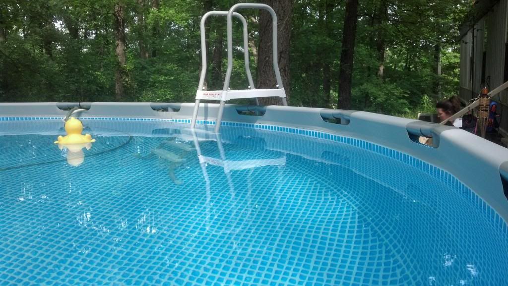

Finally got'er filled up and filter running today. Looks like we came out fairly level. It's so much better that last years floating ring pool, it's crazy. Now if the water temp will come on up we'll be good. When I started filling this morning water temp was 62 F and it is now at 66 F.

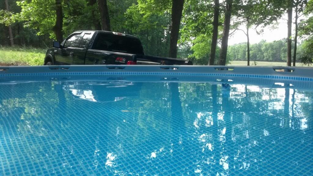

I almost forgot, I took this one yesterday...

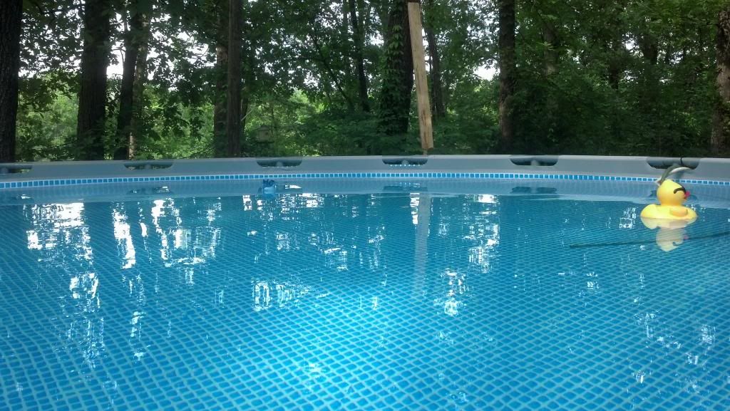

The view from the pool.
I dont see any wrinkles. What happen to 'em?
When I saw the pic you posted of em I figured you wouldnt have much of a problem.... Did you?
:scratch:
Now get some chlorine and stabilizer in there asap before it goes greener than the pasture on you.
And get yourself a good test kit.
