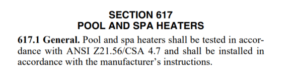

Why wouldn't any of these pool guys even ask what I'm using for a combi unit/boiler etc. in my house
"Pool" guys rarely know about installing gas lines and gas appliances.
You need a person specifically licensed to install gas plumbing and gas appliances.
Typically a plumber or HVAC person with the proper license.
In New York City, installing or altering gas appliances or gas piping requires a permit and must be done by a licensed master plumber.
You can find information on permits and applications on the NYC Department of Buildings (DOB) website.
You need a permit from the NYC Department of Buildings (DOB) to install or alter gas appliances or gas piping.
The work must be performed by a licensed master plumber.
