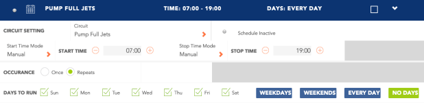

@ajw22 here's where I am at. While following your instructions, I noticed we did not set any time frames on when each virtual circuit should run so how does the IntelliCenter know when to change the speed of the pump? Also, how would I tell it whether or not I want the deck jets on based on the pump speed / virtual circuit that is running the pump speed?
What I did was created the necessary virtual circuits then created a group circuit and then used the group circuits on the pumps. After that, I created schedules using the group circuits. What's weird, is one of them should be on right now but it says inactive. If I turn on a circuit manually, nothing happens. Did I do something wrong?
Edit: I added the pool light to the group circuits and then turn them both on manually, one at a time. The light came on, but the pump did not and thus the deck jets didn't either. I found another forum post where someone said they had the same issue back in 2021 and @MyAZPool tried to help but the OP never replied whether or not he got it working (IntelliCenter - Circuit Group & Schedule Issue). This has been extremely frustrating thus far so any additional help is appreciated. Edit by Jim R.
You can only tell the IntelliCenter you want the deck jets feature circuit on at a specific time using the schedule. The deck jets feature circuit can have a pump speed assigned to it. The pump will run at the deck jets feature circuit pump speed or a higher pump speed if other circuits with a higher speed are active.
I have not played around with Circuit Groups. I suggest you keep the IntelliCenter programming as simple as possible or you start running into its quirks/bugs.
Rather then using a Circuit Group to then have one schedule, create a schedule at the same times for each Aux Circuit/Feature Circuit you would have in the group.
You say the pump did not come on. I thought you setup POOL mode schedule to run 7AM to 7AM. The pump should always be running at 1400 RPM. Various circuits that become active from schedules during the day will then vary the pump speed but the pump is always running.
@ajw22 thank you so much for your help, it's actually working now. Not sure if it's just a quirk with IntelliCenter but when I woke up this morning, everything was running as I had set it. I had to make a few adjustments since then but everything is running well with the circuit groups.
