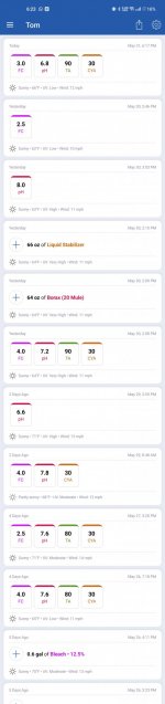

Hi everyone. Can someone please let me know why my PH keeps dropping? It's all over the place and my TA has pretty much been consistent at 80-100. I just put in borax yesterday, got my PH up to 8.0 and today it's at 6.8.
SWG still not on, salt is around 4000ppm, using liquid chlorine.
Any thoughts?

Do the pH test and post a picture quickly of the comparator block we can se the color of your pH test.

Do your logs accurately reflect absolutely every test and chemical addition?
Are you confident in your TA test? Are you sure you did the test with 25ml sample? Carefully redo the TA test with a 25ml sample and report number of drops and what you think the TA test result was...
From the last few days, yes, except adding .25 gallon of liquid chlorine.
Only other thing is last week my ph was low, I added in the exact amount of borax pool math told me and the PH was way too high, darker than 8.2. I then added dry acid to lower it back down.
