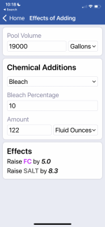

I tried looking up some labels for liquid chlorine, when you say to add 5 ppm of liquid chlorine, how do I figure out how much to add into the actual pool?
Download this...Link-->PoolMath
Configure your pool including size, and you can use the "effect of adding" feature, choose bleach and the %. Change the amount until you get to 5ppm FC addition.

Setup your pool:
Then from home screen press the three bars in the upper left corner, and select effects of adding. Use bleach and your %. 122oz of 10% liquid chlorine will add 5ppm.
