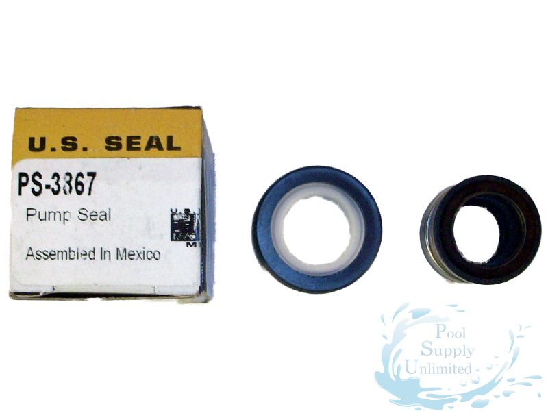

Just an FYI, I will be selling my home soon. I don’t mind putting quality parts in it, but where is the other parts to the seal kit? Will the previous mentioned kit fit/work? Thank you

Turns out I ordered the wrong parts. I have a Superflo pump, not Whisperflo. I picked up a seal locally, but now I can’t get the L/H thread impeller bolt threaded. I left it at the pool store this evening.
