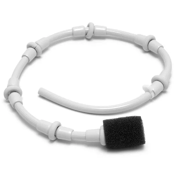

First of all many thanks for all the useful insights in this forum and it has been a great help to me to manage the pool. We have an old pool that in the house we bought and learning how to manage. I am upgrading the pool pump to an energy efficient variable speed and also replacing some of the old diverter valves (broken handles, broken lube, ..). I noticed that inside the 3 port diverter valve there is some plastic hose between the main drain & skimmer -- sort of like prevent using either one exclusively for safety. Wanted to check what this exactly is meant for and if I should use same set-up in my new diverter valve. Please find the pictures where I have high-lighted the part in question. Thanks!

Most likely, it got sucked into the skimmer line or the main drain line.
Is the main drain cover on?
380-Pool-Cleaners
Thanks a lot @Jimrahbe and @JamesW. Did not know that the main drain can suck the Polaris tail -- looks like this may have happened a while back as I do have an Old Polaris with tail in tact.
