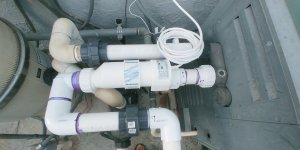

Forgot to take pics last night, but here are slightly older ones.
After I took these pics, I rotated the cell as much as I could so it faces down instead of up.

Update:. I got it installed! The process was actually a lot simpler than I thought and I feel good about the overall process. So I bought the w3aqr15 that has the salt cell, as well as the daughter board (hlaqrpcb) to allow it to hook up to the Omni hub for automation. Daughter board couldn't of been simpler. Snapped in to the aqua rite and manual was very clear on where the 2 cables went. Used some heavy duty tapcon screws to mount the aquarite box to my brick (box was heavier than I thought it would be) and I was able to very easily wire the red black and green cords to the same red white and green cords that my pump was connected to (240v). All works and all seems well.
I added the salt about 22 hours ago. Stirred it up with the brush and then put the bigger filter thing on my Hayward aquavac (mine came with a very fine filter that will get the dirt and then a filter with bigger openings that basically will shoot the dirt in the air for pool filter to grab rather than it getting it). So I put the bigger filter on to encourage it to shoot the salt straight up and mix it. Didn't take long and salt looks fully dissolved. I finally powered on the aquarite for the first time a few minutes ago and it already had the remote control option. I verified from my app that I can turn it off/on and change percentages down to the nearest whole number (such as 68%). When I click diagnostic on the app it only shows me the average salt level and the % as well as the t15 configuration. Kind of wish it'd show me the other options that I can see on diagnostics on the actual panel but no big deal.
I do have a few questions:
1. I turned it on and set it to 100%. My pump is currently at 2500 rpm (does it from 2-7 pm daily) so no issues with flow. I did notice in the first return some bubbles rising to the top. I panicked for a minute afraid I broke a return pipe somehow or had a leak because I've never had bubbles before. Do not see any leak so I googled some posts here and it appears to me that that is normal with a swg....the bubbles being hydrogen. Is that correct? I'll attach a pic. Only doing it in the first return and maybe slightly in 2nd return. Nothing on returns 3 and 4. Bubbles stop when I turn off swg.
2. Instructions say wait 24-72 hours for salt to fully dissolve but I was impatient and had to jump the gun just to test it lol. It shows my average salt is 2800 and when I go through diagnostics to get a snapshot of current salt it varies betwren 2400-2800. My target was 3200 but my k-1766 will not arrive until Monday according to tracking. So on the way to buy salt yesterday I figured I'd run by the pool store and I could at least get a ballpark on where I was at, and err on the lower side of what I wanted. He stuck a digital thing in the water and it said 600. So I figured up the math and added enough to do 3000 knowing I could add more later after I get my test kit in Monday and check it. My question is, is 2600-2800 range unsafe to run the swg? Will it damage anything? I did notice maybe 30 minutes after it's been running the low salt light came on and inspect cell light was flashing.... assuming this is all due to low salt. In short, will it hurt anything if I continue to run swg or should I just kill it until Monday when I can do a real test and maybe add a few more bags. Just wanted to err on the low side so I wouldn't overfill. I still have plenty of pucks.
3. I've attached some pics of my setup. Does anyone see anything wrong with my overall setup? Ideally, I wanted the salt generator to be upside down because I hear that's best practice with a vsp. Because that pipe sits on concrete it just wasn't really possible in my current setup...I couldn't raise the pipes high enough without fear of breaking it. I could raise it on the heater side but that last elbow really doesn't budge enough to raise that up enough for the bottom of the generator to work on that side. Is it ok to leave it like that or should I buy another elbow to raise the pipe up on that side and flip the swg over? Decided to just take the tab chlorinator out. I didn't have enough space and the thing has been acting up lately anyway.
4. I left my check valve on there from the tab chlorinator but obviously now I don't really need it. Will it hurt anything leaving that there? My flow switch is after my salt cell...does that check valve being there at all handicap the flow? At 2500 rpms, no flow issues at all. However it does appear that around 1500-1750 rpms is when the no flow light comes on for my setup. I am due to clean my cartridge filters so that will help. My pump is never below 1750 rpms but I do want to make sure the flow valve will never detect that 1750 is too low.
That's the main questions I have. Figured I'd ask those that are familiar with this some of those questions. This board has been amazingly helpful.

Thank you for that link. Well this listed here pretty much addresses my problem. Guess I should of done a vertical install. Would of been nice if that had been on the manual:
"When using a variable speed pump it is recommended that the cell be plumbed in vertical position. By doing this the cell will fill even when the pump is running in a lower speed. If the cell is plumbed horizontally, and the pump is running in low speed, the cell will not fill completely with water, and cause it to read a false low reading."
Reactions: HermanTX
Another update. For those that have SWG, if you do horizontal inverted instead of doing a vertical install, is that sufficient? I was able to get the pipe raised just enough to get it locked in inverted so now I have the swg installed upside down horizontally. My pump has been on medium at 1750 for the last hour and the salt level on the diagnostics is still holding at 2800 compared to the 1300-1800 it was showing last night so I think I might be in the clear without having to do a vertical install.
So for those that may ever read this in the future, it seems to me that it's very important to invert your install if you have a vsp. I looked at the aquarite manual and though it doesn't say the word invert in the instructions, the picture they show does it show it inverted so they are basically saying no matter what invert it.

I have a different cell (Jandy AquaPure). The manual is extremely clear about installing with sensor down so an air pocket can't expose it. In fact horizontal with sensor down is the preferred installation. Cheers. Glad it's working out.
Yeah, that's a bummer. I knew the vertical plumbing recommendation was primarily a safety issue; if the SWG runs in a low-flow situation it is possible to have an accumulation of hydrogen gas, which can (and has) caused the rare detonation of pool plumbing. It looks like you've still got the ability to change it if you wanted, or it might even be able to install some kind of air bleed valve after the heater to clean up the flow. Now that you're more familiar with the plumbing (it's a whole lot easier than it seems), you might consider a true bypass for your heater. That'll allow you to run even lower RPMs on the pump, as the heater is almost always the most restrictive component for flow rates.
