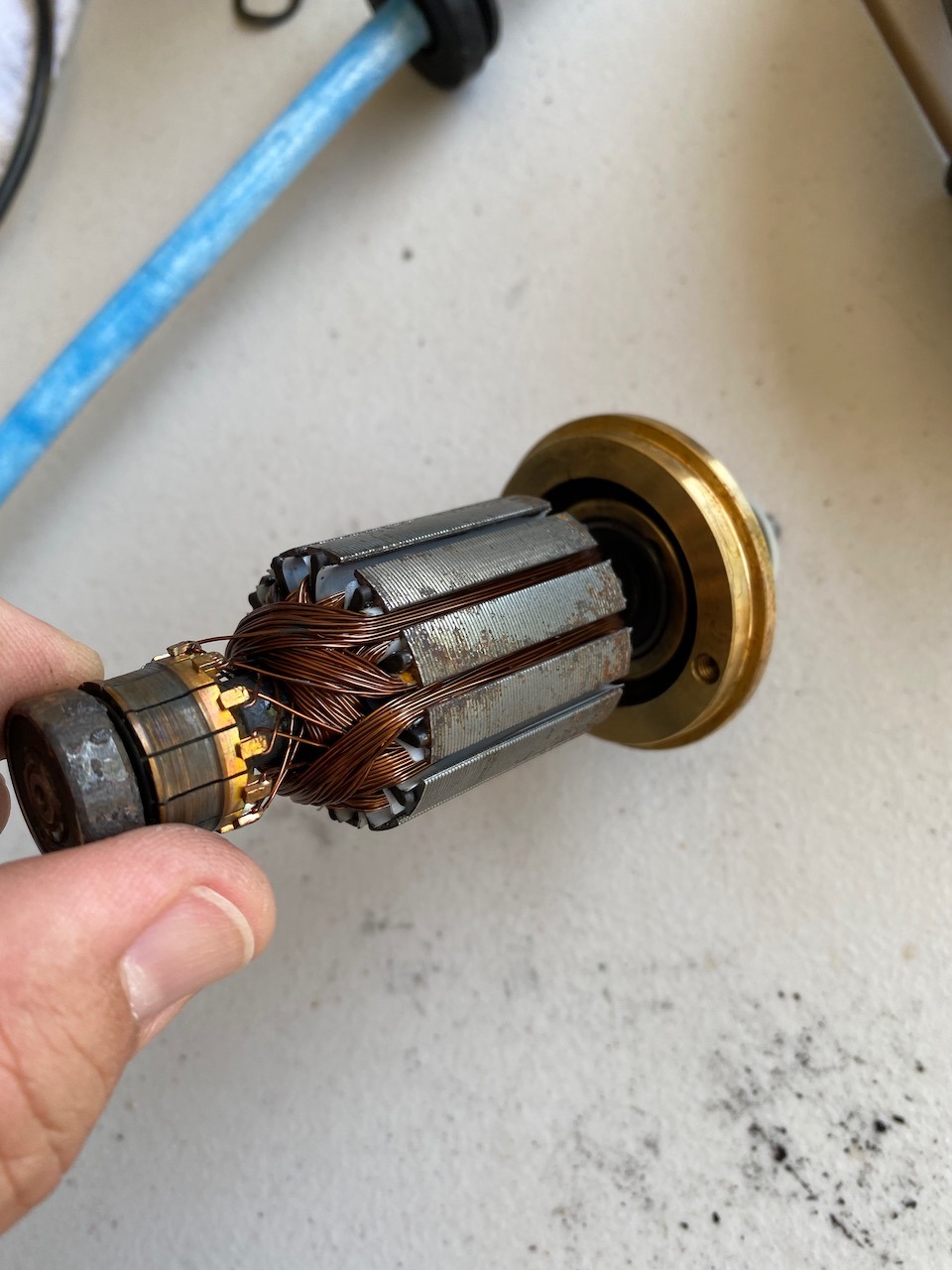

Cleaning up the motor and parts in anticipation of new bearings and carbon blocks -
That rear bearing really is shot. After cleaning it up it really does not turn smoothly at all. Thankfully the front bearing is fine as it turns very smoothly.

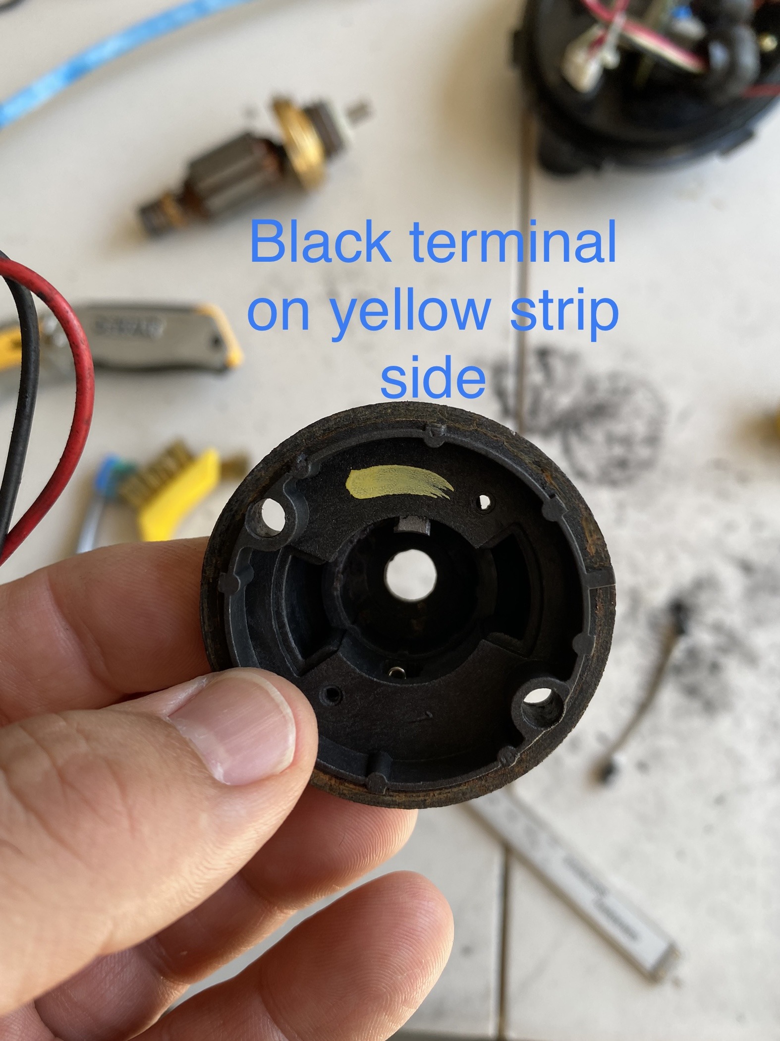

Also, the back plate that houses the carbon brushes has a red and black wire. These are brushed DC motors so polarity matters. If you connect the wires backwards then the impeller spins the wrong way and you'll probably launch the robot out of the pool ... yellow strip under the cover plate corresponds to where the black wire is connected ...
If you have a drill press I'd grab one end in the chuck and the opposite side still with bearing attached in a vise below and clean up the commutator. It looks like it's not flat where the brushes make contact. Also scrape clean the lines between the commutator segments.
The commutator is not flat, it’s scalloped slightly. I don’t know how much that will matter as it was like that when I opened it up. And yeah, I need some thin stiff plastic to clean in between the segments.
