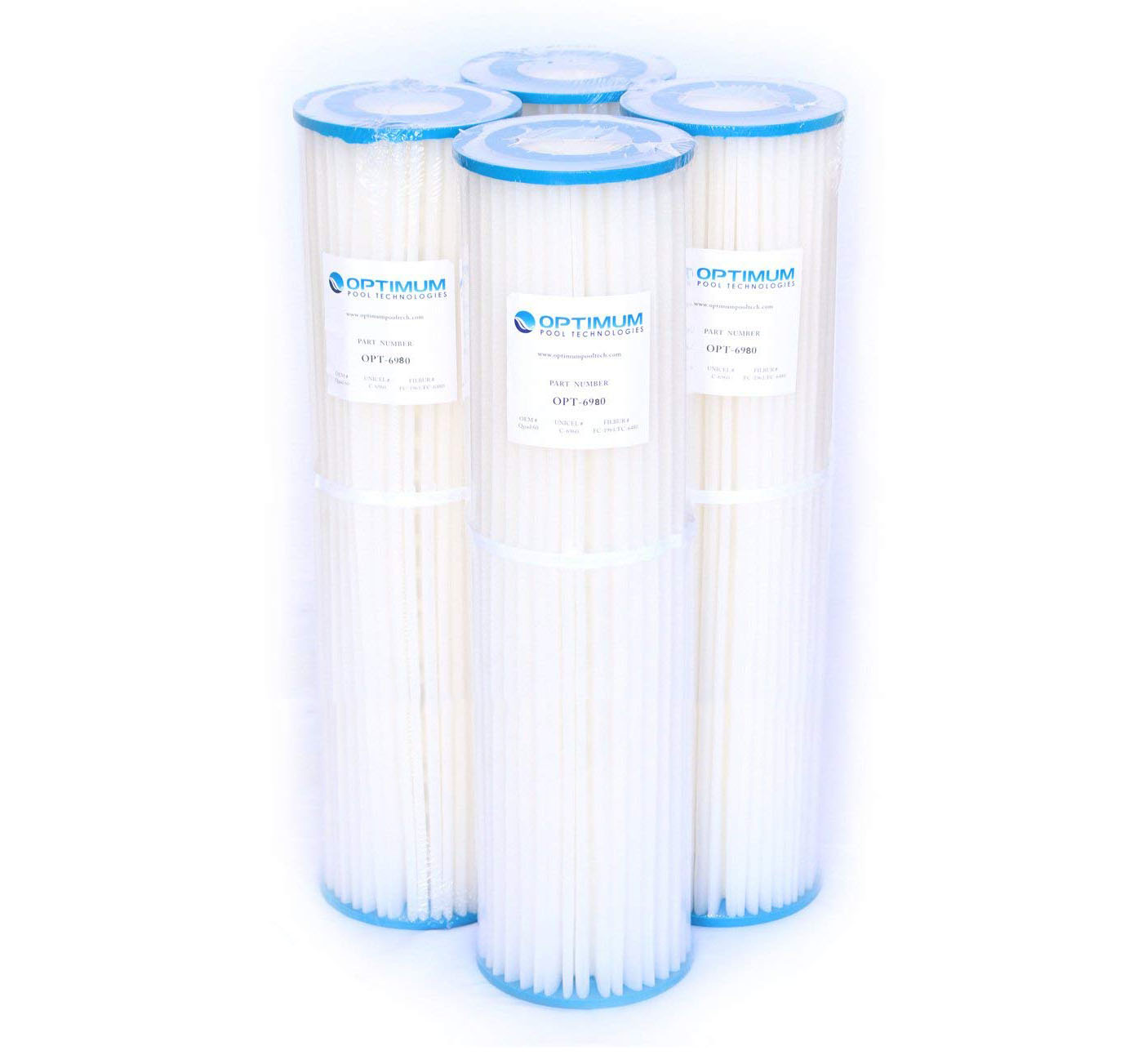

Hello, probably a dumb question. But just curious, is it possible to have regular cartridges on a Pentair Quad DE filter?
Just in case the regulation changes on my county/state about DE on the sewer or just tired about DE.
If possible, probably not possible to use the backwash valve anymore, correct?
I had researched this before and found an answer on the Pentair website. Although possible to do a conversion, its probably not practical...
Is it possible to swap a quad DE cartridge filter elements with standard Cartridge filter elements?​
1answer
  1. Tech Support, Dan W.
    · a year ago
    The shell of the Quad filter is the same as the CCP cartridge filter. For the most part that is where it ends. The internal parts are different. Short answer to the question is, no.
Which model Quad DE do you have?
If you can find cartridges with the same dimensions, it should work.
The dimensions that need to match are length, outside diameter and inside diameter.
The different models should use the same inside and outside diameter and only the length is different.
The outside diameter is not super critical as long as the cartridges will fit in the holders and not touch the filter body.
You can probably go to a slightly smaller outside diameter but I would not use a larger OD.
Getting the exact dimensions would be best.
You can measure or find the dimensions online.
I would measure to be sure as the online dimensions are often questionable.
If you don't like DE, you can use filter fiber cellulose.
Backwash never works well on a Quad DE, so I would never use backwash with the DE or regular cartridges and just disassemble and clean.
The Quad DE 100 uses a set of 4 cartridges coated in pool grade diatomaceous earth to provide filtration.
The cartridge dimensions are 32.75" x 6.25" x 6.25" with a 3" center hole.
The Quad DE 80 uses a set of 4 cartridges coated in pool grade diatomaceous earth to provide filtration. The cartridge dimensions are 27" x 7" x 7" with a 3" center hole.
This reference says a 7" OD, but this is probably incorrect.
Most other references say 6.25" OD.
Aside from the cartridges, the QuadDE and CCP filters are exactly the same. The only thing you’d have to plumb differently is to remove any backwash valve from the system because cartridge filters can not be backwashed. Other than that, as long as you get the correct sized cartridges so that the upper manifold height is the same, you can turn a QuadDE into a CCP filter. Pentair doesn’t want you doing it because they’d rather sell you a new filter.

Having done at least 4, the answer is yes, just match cartridge size. Some of the Quad filters had 1" pipes in the manifold. Remove them. They were there to make sure that water evenly coated the DE cartridges.

Right now, I am debating between a CCP filter and a DE, I will "probably" get the quad DE 100.
I was believing, like you guys, Pentair would difference their filter with 1/4" diff or so just to avoid this kind of switch and be able to sell another filter... So I didn't check the dimensions at all yet, I just wanted to be sure and have your opinion on the "technical capacity" to switch cartridges without blow the top cover filter (or I don't know which craziness).
Plan to have the FullFloXF valve mounted on it. Backwashing the regular cartridges is a hazard issue or it would damage something? I will not, just curious.
