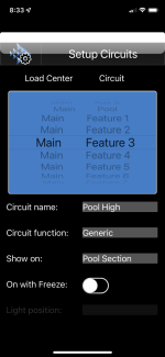

Spa has Spa circuit function and Show On Spa Section. If I try to make a new Spa Low feature circuit it allows me to Show On the Spa Section but it does not let me choose Spa for Circuit Function like my Spa circuit has. I just noticed that my Pool High has Show On as Pool Section but has Generic circuit function. So I can't create more than one feature circuit for a circuit function? Pool High works as expected because Generic circuit function doesn't move the valves, it leaves them in Pool position. New Spa Low feature circuit cannot choose Spa circuit function, must choose Generic which doesn't move the valves, to Spa position where I want them.9DA69C14-AE72-4039-AC07-B7126094E28A.png9DA69C14-AE72-4039-AC07-B7126094E28A.png

I learned that what I thought this morning was wrong. :(
I screwed with this for an hour or so and found that you can only have one Pool Circuit and one Spa circuit. You can name them anything you want, but only one of them can have a Circuit Function of Pool or Spa.
The default is that the Pool Circuit has a default Function of "Pool"
You can Name the Pool Circuit "Pool high" but the Function is still "Pool"
If you Name a Feature Circuit "Pool Low" or Pool High" it will not let you change the Function to "Pool".
I am not sure how your Pool high and Pool low works, but I'm pretty sure it is not working like you think it is.
If you had a PC, with ScreenLogic loaded, we could solve this issue in a few minutes.
This set up page ties everything together and make programming very easy.
Sorry, wish I had better news..
That is the deal, only one Pool and one Spa feature circuit that use Spa and Pool circuit function. Thanks for helping me dig into it. I will probably be back with more square zero questions.
