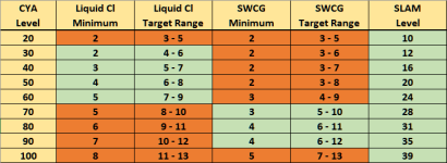

You should be testing and dosing FC to target levels daily. Your FC is dangerously low. Look at the chart below for proper levels.

Your pH is fine. Don't go below 7.0. When it reaches 7.8, lower it to 7.2. Continue the cycle as lower TA levels will help to stabilize pH rise.
Thank you for this table. My pH was 8 on Friday, so I treated it and it dropped to below 7, but then 2 days later it increased to 7.2 today , now with cl, should I treat right away or wait until night time? I feel I’m using a lot of cl. Yesterday I put 2 gallons, 1 in am and another at night. Should I add cl now or wait until nighttime?
Add chlorine immediately. You need to get it up to target level. Test again tonight and take it to target level. Then, you should be able to maintain it daily with one test. If you're losing more than 4 ppm per day, you may have a problem.
