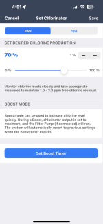

When on auto and I try to manually change I get "JA" indicator - NOT "Jo" as said above.
That indicates that the Aqualink is communicating with the Aquapure control panel. You should not be able to make changes on the Aquapure control panel.
