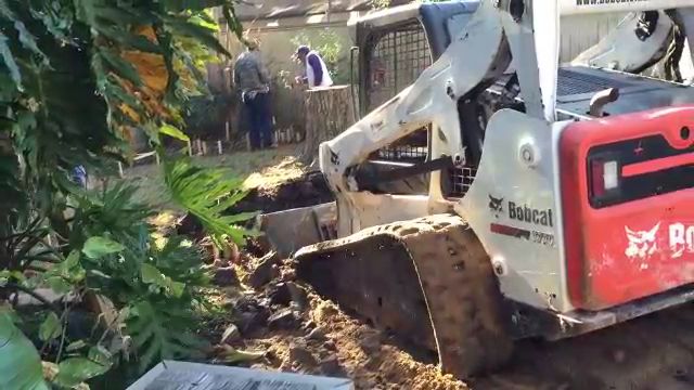

Denise, you asked about a timeline. The PB wants to do:
Today- dig
Tomorrow-steel
Friday-gunite
However, we will not be home on Friday (actually only be home a few hours in the a.m.). We had already scheduled a trip up north to see my mom since we didn't go at Christmas. When I asked if we could move gunite to Monday, he said he really doesn't like leaving it open that long. Plus there's a 40% chance of rain on Monday. BUT, if the dig takes longer than today, then it would have to be moved. So in some ways I hope the inspector doesn't come until a lot later!
