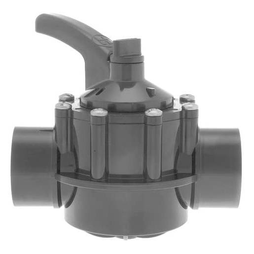

The best thing would to get something like this:
Replace the ball valves with 2 way diverter valves.
Jandy, Hayward, Pentair all have diverter valves. Shop around for availability and price.
