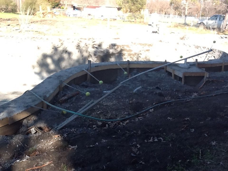

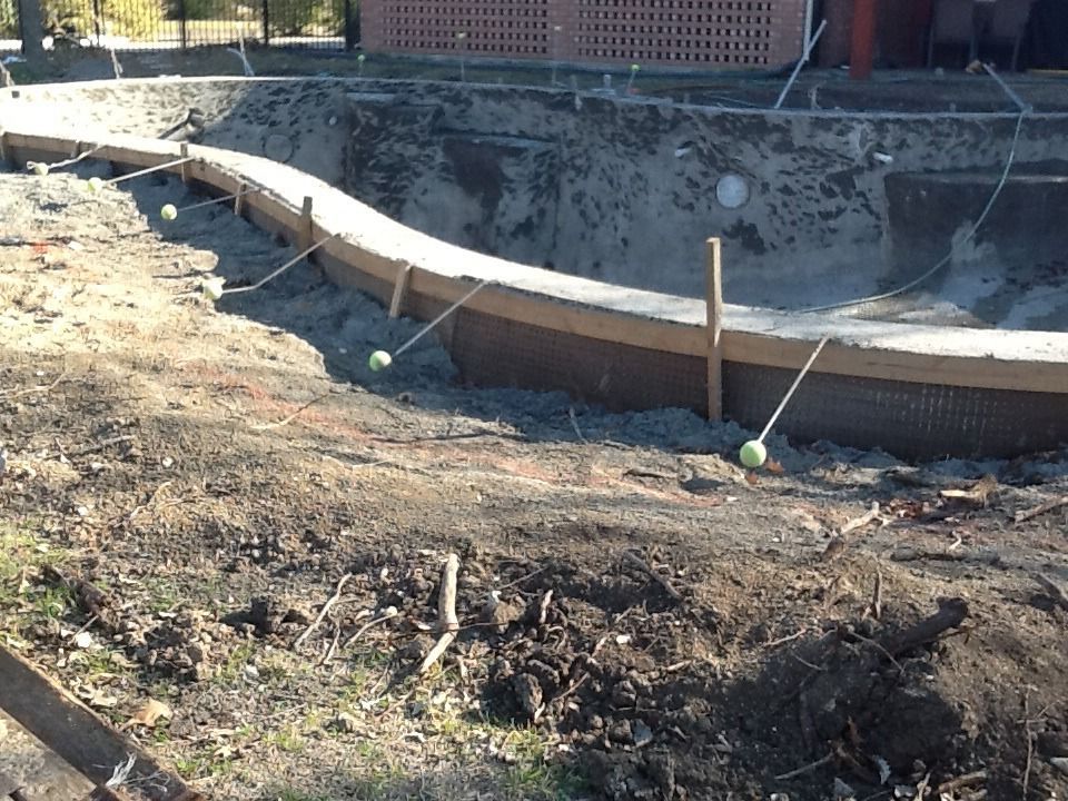

Some pics to show how much needs to be filled. These spots are the worst:
All the concrete that has been installed at my place has had 3/4 drain rock under it, since there are no fines in it it is 98% compacted when it is laid and doesn't need any more. Definitely with sand or road bed you need alot of compaction.
Just a warning about base materials and concrete in general. Location Location Location. Different areas of the country use different materials some are better than others but most base materials handled correctly work fine for residential pool decks. They aren't being run over all day long and stressed by hard tired electric forklifts making turns. And some areas of the country use the same materials and describe them differently. Finding a good contractor and seeing some samples of their work that is five or more years old is a good test. Also if the price is low they may be omitting something. Make it clear what you are paying for. Rebar 10 inches on center. Spell it out. Integrated color vs surface color. Compacted to 90%. Many of these subs are just going to ball park the specs so you have to be there to see what they are dong and gently guide them towards your true path (the contract you negotiated). And don't add extras after you cut the deal without expecting extra costs and delays.

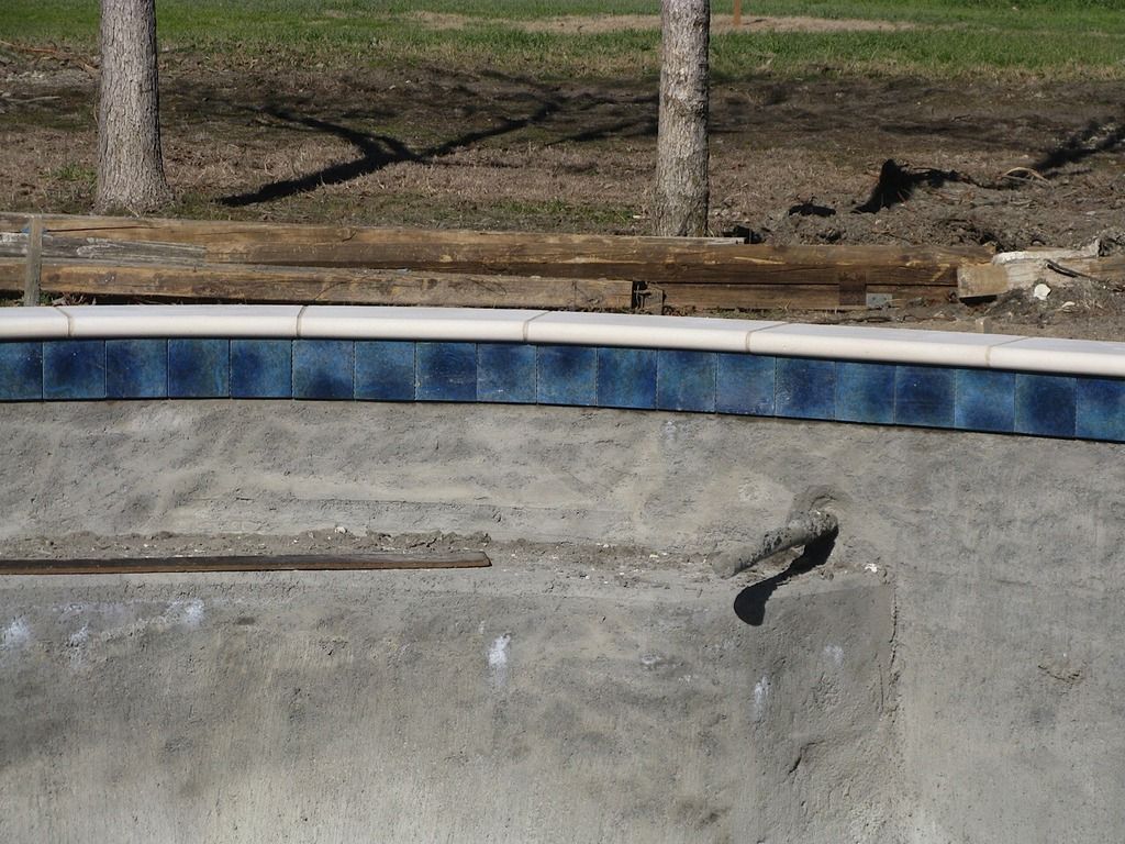

Here are a couple of photos from today's tile and coping. It's all done, except for two missing ~2' spots of coping where they didn't have the right radius curves, I guess. I like how it looks. Maybe not as fancy as others I've admired on here, but the glass on the tile steps will be my little splurge (thanks to the influences, good or bad, of TFP and it's bling! :) ). They will come back tomorrow to finish. It was too bad they didn't have what they needed. They were so close to being all the way done in one day!
