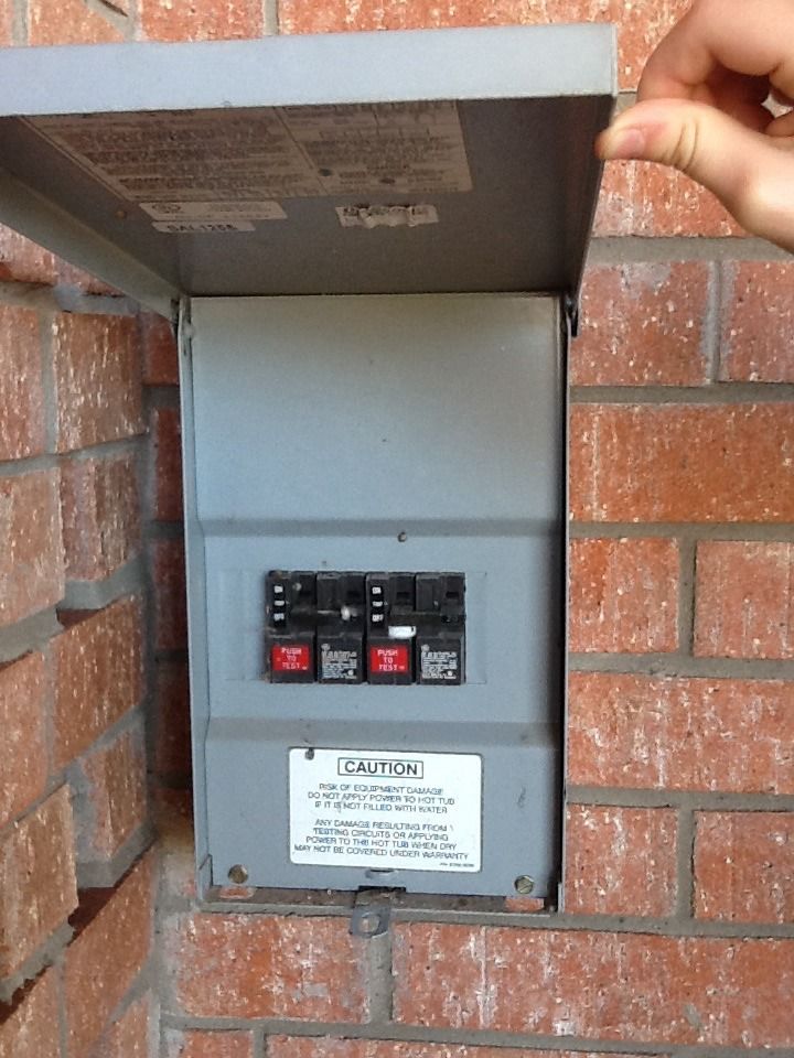

something like the below would be my preference in your case. mounting on fence not ideal, fences sometimes get blown over is texas wind storms. this way you're not reliant on how well the fence was installed.
