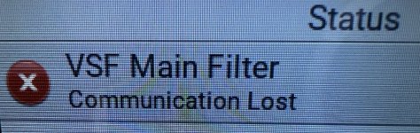

Rob,
If the screen on the pump says "display not active" it means that the IntelliCenter is controlling the pump. But, it is possible that the pump is not talking back to the IntelliCenter.
If there was a communication loss you'd think the "Status" page would show it. :scratch:
Show us a pic of the error message so that we can see the whole page.

OK so I will show you the screens on the IntelliCenter itself as well as screenshots of my phone. My phone seems to show communication.
The last 2 are cell phone screenshots.
You will also notice when the pump is running only the filter and namely not the booster pump for the Polaris or the heater or the spa it should be at 1100 RPM but it is significantly more at the moment.

Rob,
I agree with you that there is an issue. I wish I knew what it was. You are 100% correct that based upon your screenshots the system is in the Pool mode and that the pump should be running at 1100 RPM. When this happens, if the pump's display says "Display not active" I would have to assume that the IntelliCenter is talking to the pump, but the pump is not talking back to the IntelliCenter.
I assume this is a new system and still under warranty, I suggest you call your pool builder or Pentair and have them come look at it.
