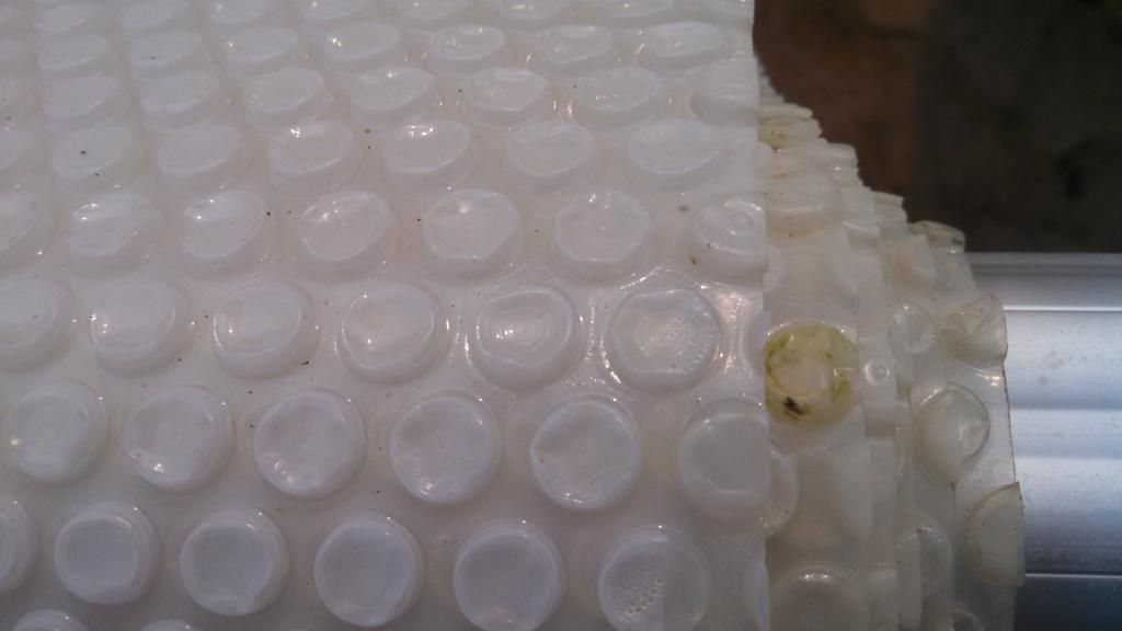

Thinking about it further, it looks like you reel up your cover when home, then put it back on when you leave. Am I right?
If so, there is some drag-out water captured by the bubble cover that will stay stagnant in the roll there while reeled up. The FC in that little volume of water will dissipate quickly and then you'll have the perfect environment for bacterial and algae growth.
I say stop using the cover for a while and put your auto fill back on. Let your pool breath naturally while you're away and take the cover out of the equation entirely. Honestly, at this point, any water loss through evaporation is inconsequential compared to how much you've spent on chemicals so far trying to keep up with the FC loss.

I closely inspected the cover, most of it looked pristine like this
However I had a few bubbles on the edge that looked like this, but is it really possible that this spec of algae in 2-3 spots could cause all my issues ? I will take it off, sanitize,etc..but just curious if this little amount could be my demons.
Re: Unexplained FC Consumption (updated title)
Let me ask you something - why are you using the cover? Would it cost you anything to just leave it off for a week or so and see what happens?
I can't answer the question as to how many small specks of algae equals a problem, but we need to eliminate all possible sources. So I say clean the cover then roll it up and forget it for a while.
