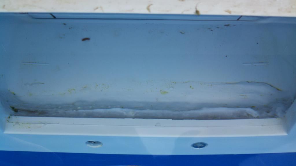

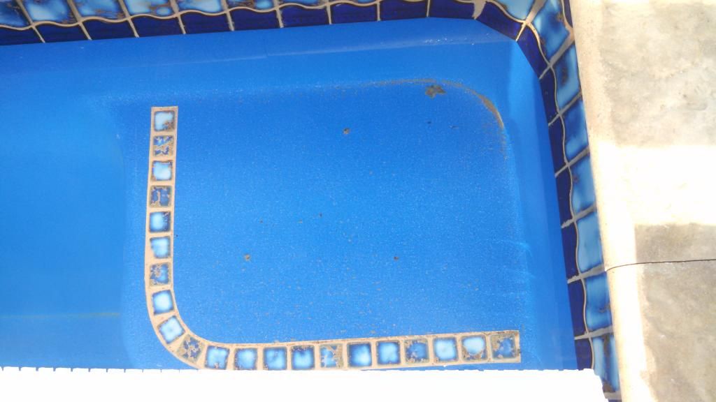

Since my CYA is on the lower side, I guess that does not seem terrible. HOWEVER look at the picture below. HOW IN THE HECK IS ALGAE GROWING. This is my first visible sign - really or am I still sleeping. This is in the mouth of the skimmer. Now I have 3 suctions, and when I travel I leave the 2 main drains on in case my kids drops a toy in the skimmer thus clogging the intake...so I am not getting a ton of water flow, but still - this is nuts.
Here is the normal "dirt" I get in the pool, that sort of looks like sand/fine sand...but it is on the steps above the returns, so it can't be coming from the filter. As you can see the WATER is still super clear, yet I have visible growth.

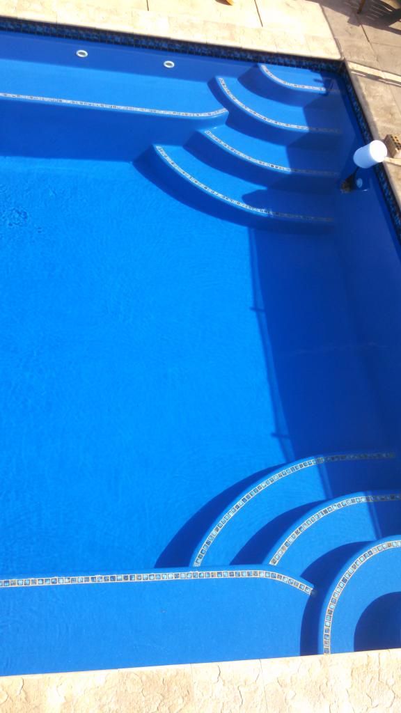

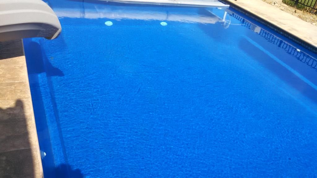

That is a pretty pool!
I do wonder though................you say you are gone quite a bit............could some "friends" in the neighborhood be coming by to "check" out the pool?
Just an idea.
