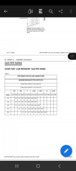

4. Fix gas line
Contact your propane supplier as they may be willing to make the corrections for free. The 1/2 flex copper is insufficient to supply the mastertemp 400 at low pressure. You currently have a 2 stage system (10psi regulator at the tank , 13" water column regulator at the house) so likely the easiest solution is to supply the 1/2 from just before the low pressure regulator then add a second low pressure regulator at the heater. At that time they can add the required shutoff valve and sediment trap.
