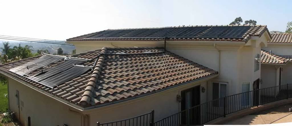

Thank you all for your support. I can't wait for it to be done! Today the solor went on mostly. The south faving roofs only got about 70% of the pool area (estimate was 80% by solar company). I decided to leave it at 70% instead of going east face up to 85%. The east face is very visable from the pool, while the south side really can't easily be seen from anywhere.

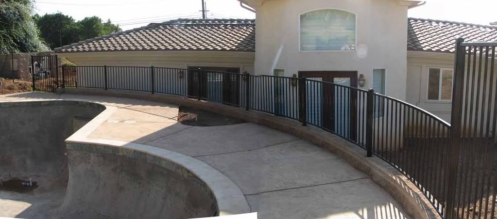

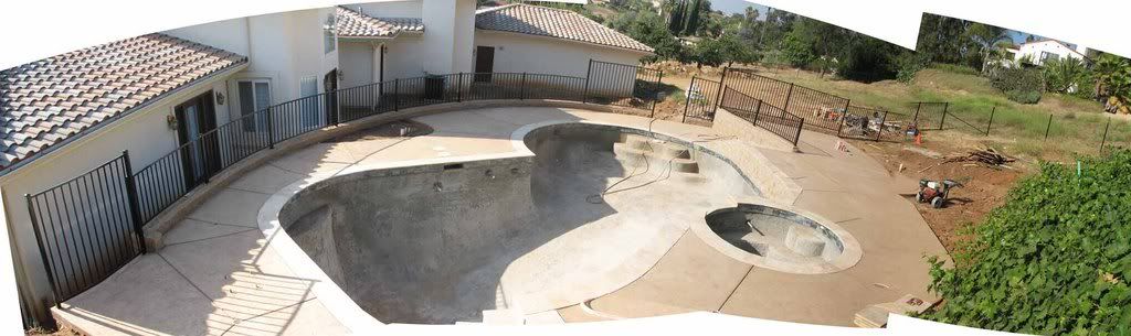

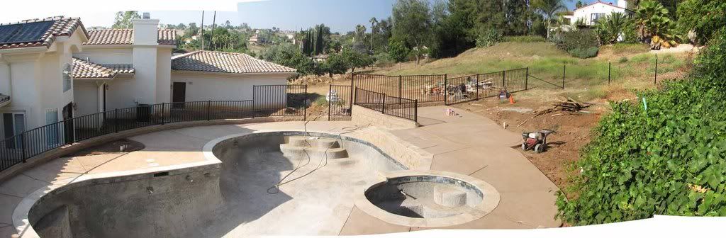

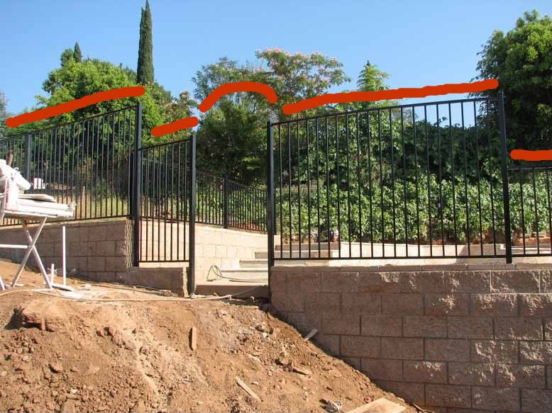

OK -- fence is mostly done. There's an area that can't be put in final until after the landscaping walls are in. I had to convince the fencing contractor to put in a temporary segment. Overall, though, he did a really good job. He welded it all together -- I've seen the California wrought iron (hollow) being bolted together (cheezeball).
I feel the space is very closed in -- feels like I'm in jail (not that I'd know what that was like). I'm sure it'll be better with landscaping. Also I'm used to is being wide open. A friend said I should have fenced the yard -- not the pool, and then put a smaller (but functional) barrier around the pool. Here in California to meet code the fance has to be 5'-0" high. In some areas the fence is close to 6'-0" because the CMU starter-wall is a foot or so.
I really like how the 36" rail worked. I was able to do this because the CMU wall is 5'-0" -- that became my barrier.
There's a lot of steps in the height of the fence.... I might adjust some of it later. (Oh, but I hate to pay to have things re-done.... :x )
The curved-top gate comes in Tuesday -- I'll call for Inspection Wednesday. Plaster is unlikely to be Thursday -- hopefully Monday then we'll be swimming by the 12th!
Here's some pics:
Lots of steps in height:
Low 36" rail :-D
Solar Installation:
Except for some pipes on the roof, I can't see the solar from 90% of my yard -- it's invisible!
