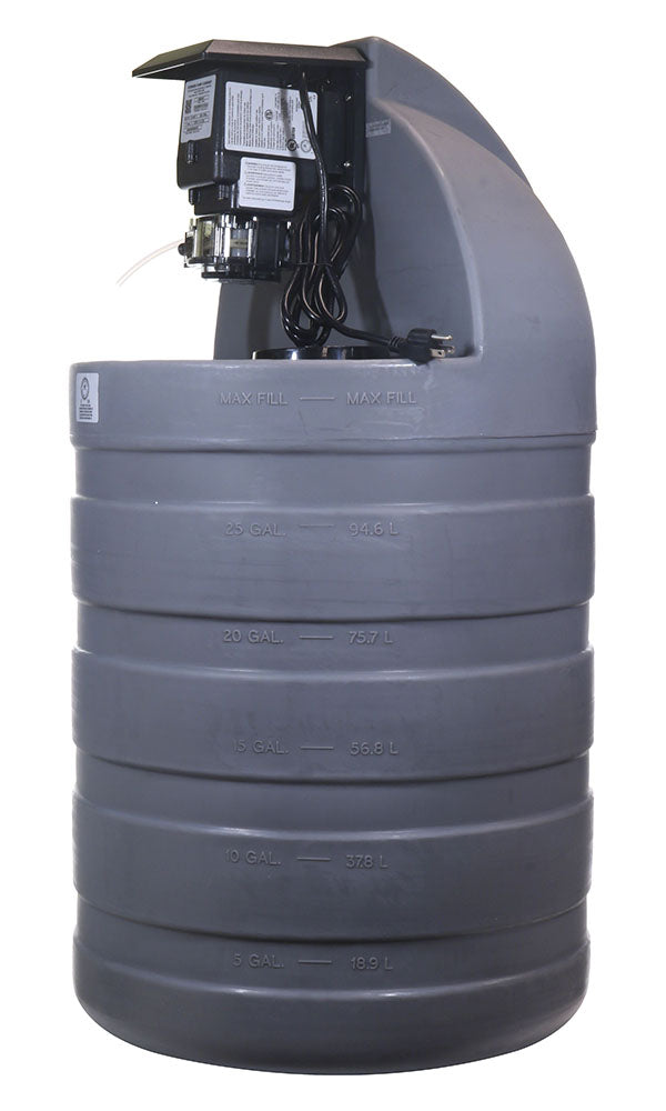

View attachment 84723View attachment 84724
My Stenner pump and my supply of 6% bleach. This is more than I will use for the rest of this season. I don't like to haul bleach. 2 trips a year is all it takes. The good thing is that at lower temps over the winter, the half life should be > 3 years. So it will still be OK to use next year. Just to be sure, I'll do a check on the leftover bleach strength next year.
