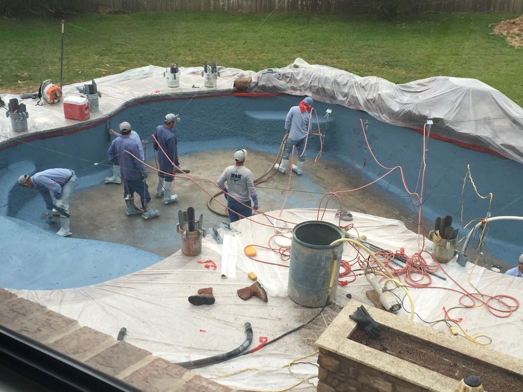

If you want to make them really happy, go out and buy some breakfast for them! MMG did my pool and does excellent work!
HURRY up guys!
Kim:cat:
Oh beautiful! Love the blue surf!
love it!!
PRETTY!

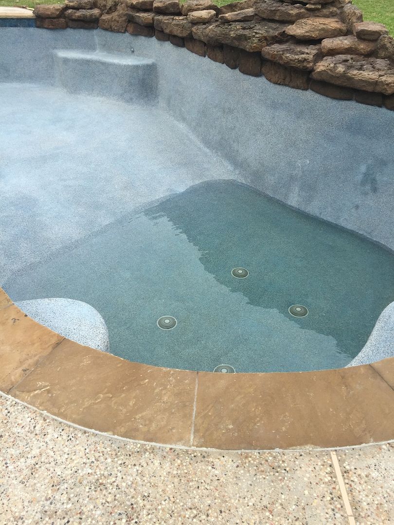

When they come back tomorrow for the acid wash, make sure to go and look for any areas that may still have a bit of "cream" left over. I had a couple spots near my drains that were a bit lighter than the rest. PB came out and put 8 gallons of acid in to help break it down. After a week of brushing twice a day and no swimming due to low PH; it's finally starting to fade out. PB said it would take about 2 weeks, but if the guys with the acid wash would have given it just a little bit of brush...I wouldn't have had to deal with it. See pic below by drains and you'll notice areas I'm talking about. Note: You can see them way better with polarized sun glasses.

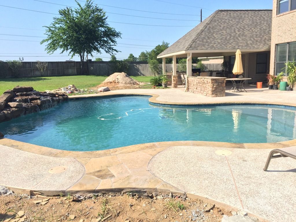

Nice! Your pool looks great. If you can swim in 24 hours that would be awesome!
