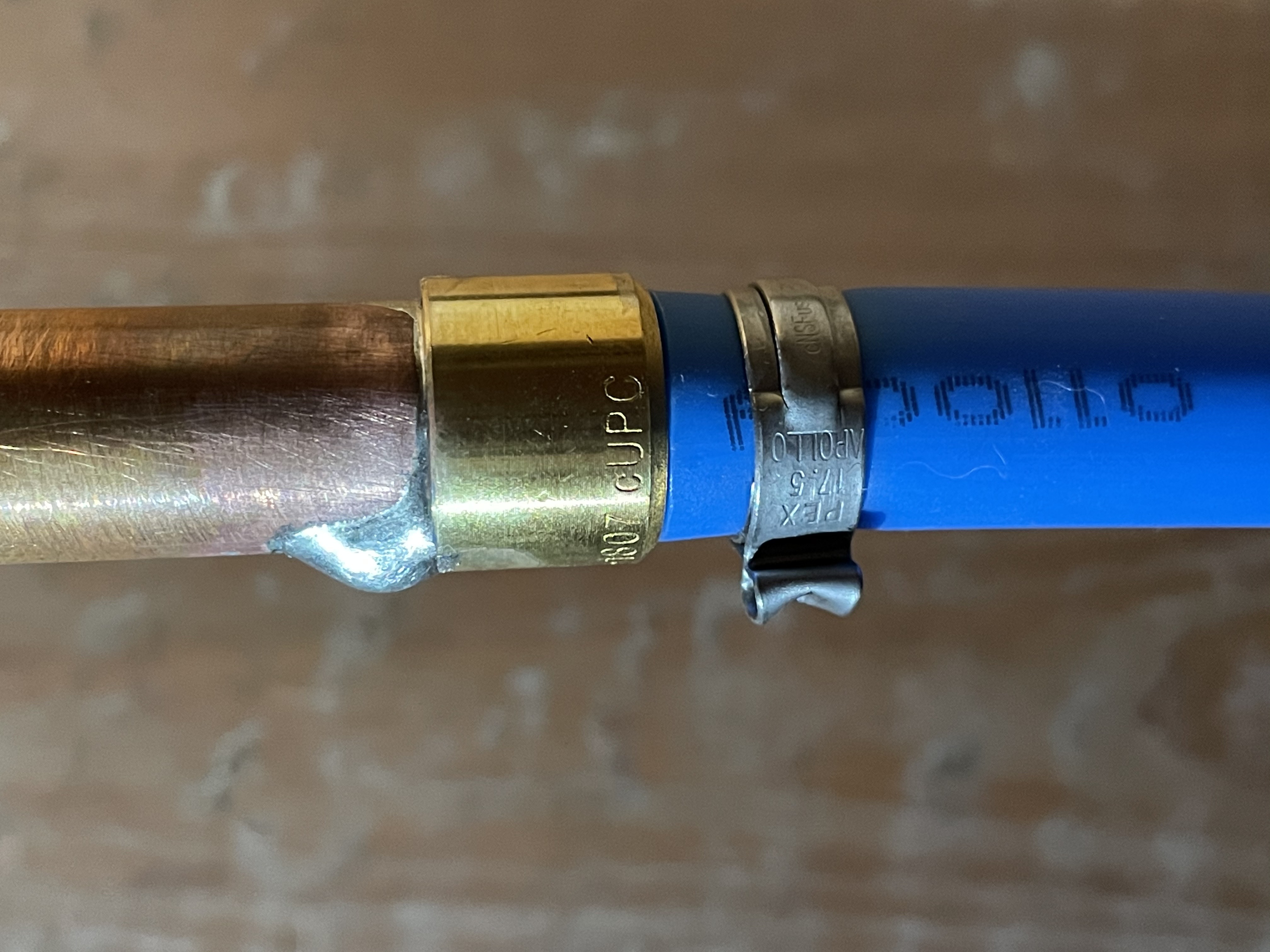

I thought about it. I thought about it really hard, looking at the 1/2" to 1/2" Sharkbite valve. All I'd need to do is cut the copper and stick that onto the existing copper pipe, then stick in some 1/2" PEX on the other side. But something in me balked, perhaps it's the issues we've had with certain types of hose and push to connect fittings at work, that I just didn't want to use Sharkbite for household plumbing.
Instead I got a solder/flux kit, picked up a small torch (I had a big one but it'd be overkill) and soldered in a PEX adapter. It was easy and went well. Used too much solder, next time I'll have to tone that down a bit.

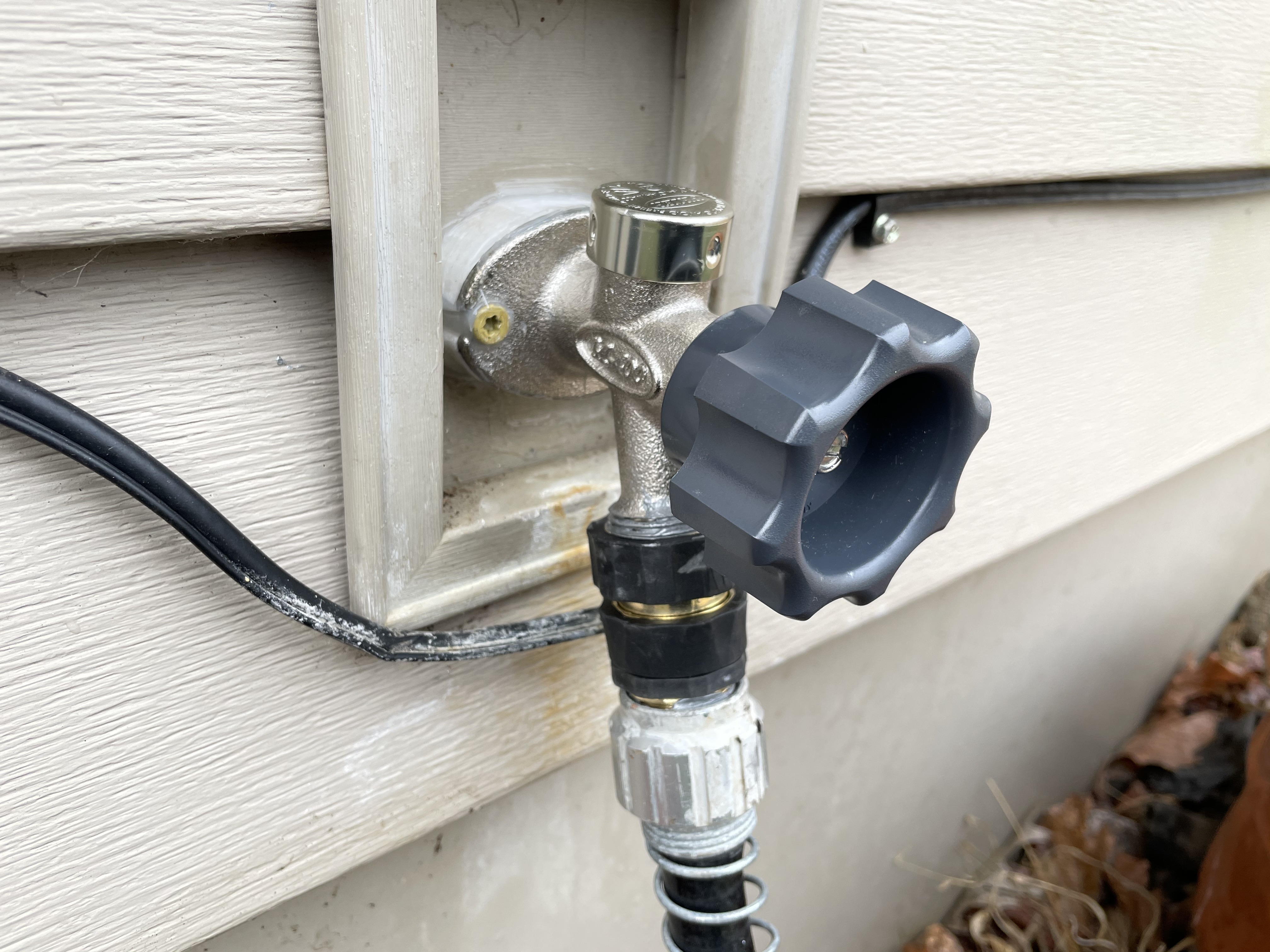

The previous owner had installed the outdoor spigots too close to the house, you should barely get on the "modern" garden hoses with their wide ends for easy gripping. So I built a spacer out of some scrap cellular PVC I had laying around.
Got the new spigot installed. It's the more expensive model, with a 1/4 turn valve. So much nicer than the multi-turn valves they normally are. While at Home Depot I thought about winter spa top-offs, and decided I didn't want to fiddle with screwing and unscrewing a hose each time. People in parts of CA and the south don't have to worry about this, but where it freezes in the winter you need a self draining spigot. The actual valve is in the house where it won't freeze (12" back in my case), and it's mounted with a slight downwards slope so water drains out of that section of pipe past the valve. But if you leave a hose connected it can't drain.
So I got a quick connect garden hose fitting. This model had a water shutoff so you can hot swap hose attachments, but that would trap water. So I punched out the little valve thingy in the quick connect so it would be able to drain when disconnected. Then I attached that up. Now when I fill my spa I can pop the hose on, fill, pop the hose off and the spigot will drain. The hose side of the quick connect had no water valve so I can easily drain the water out of the hose before coiling that up so it won't freeze either. This should make filling in sub-freezing weather a slightly faster process too.

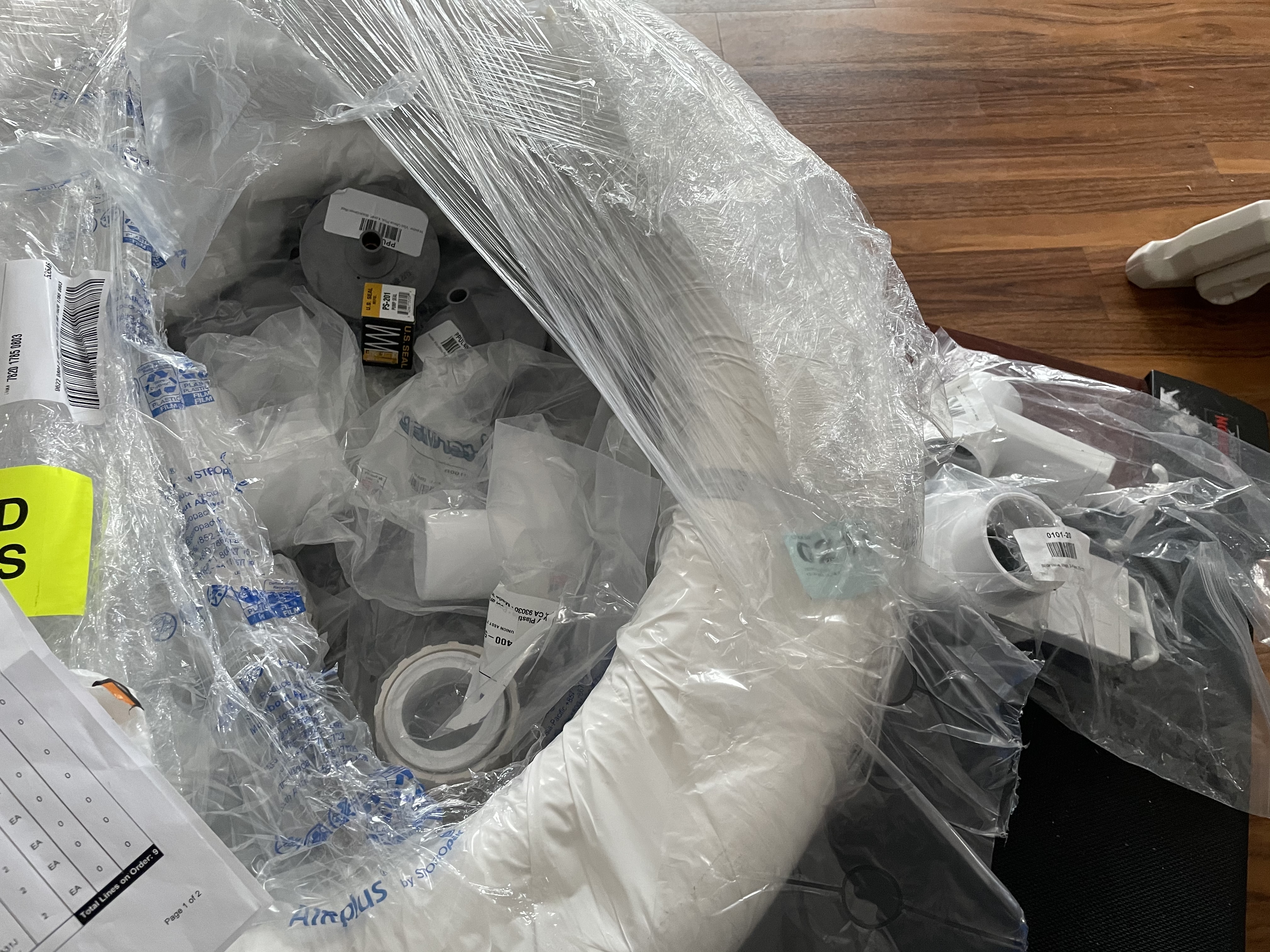

I got the new seals and impellers from SpaCare, along with a lot of PVC fittings and some new flex PVC cause I have at least one bad valve and I suspect another so I need to swap those out.
I got 6 new bearings ordered but it’ll probably be the first week of January before those come in.

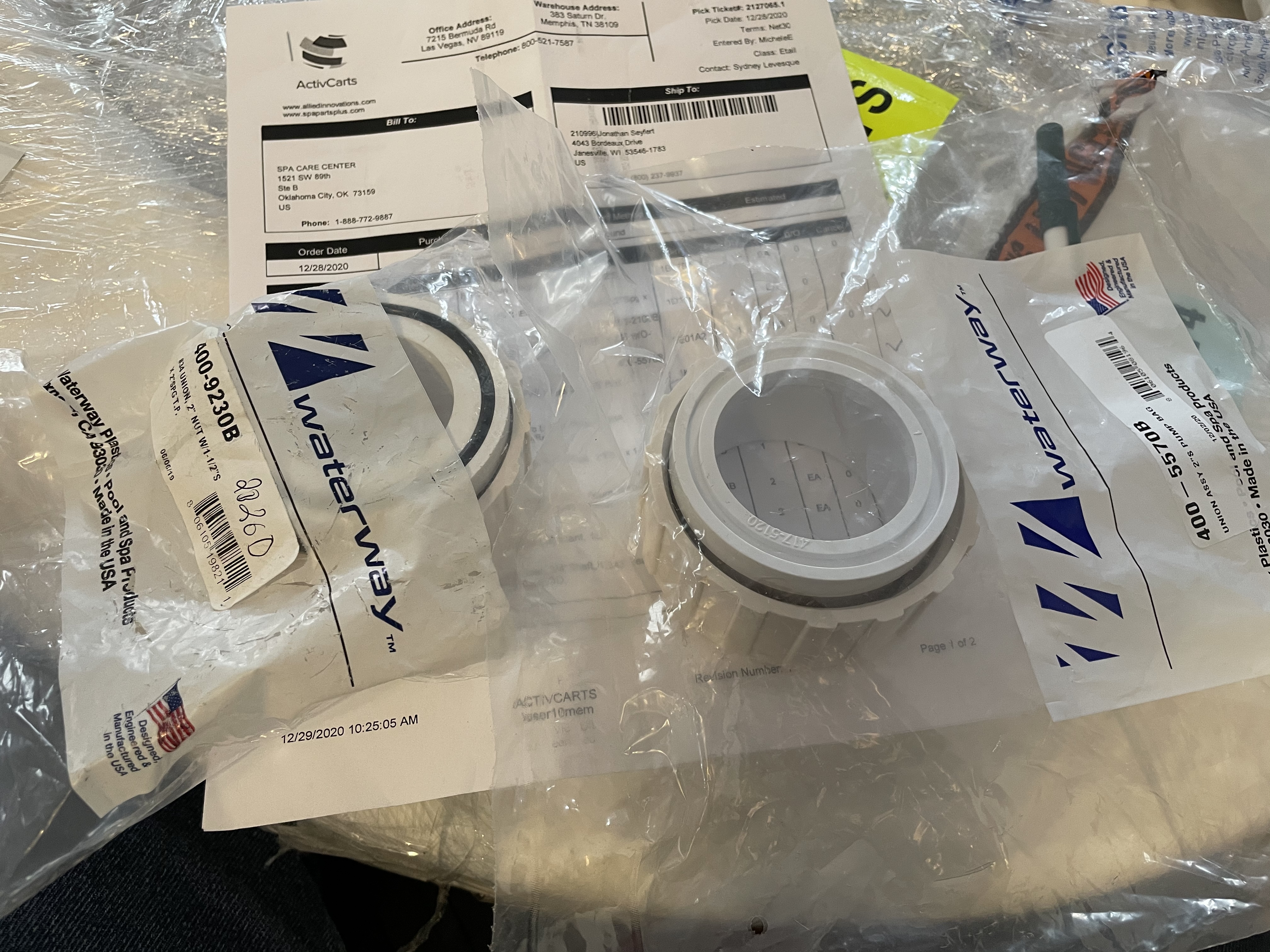

Update: Got some new parts, including flex PVC for flexibility it redoing plumbing and future repairs.
One of the two pump unions didn’t have an oring. I contacted them about this.

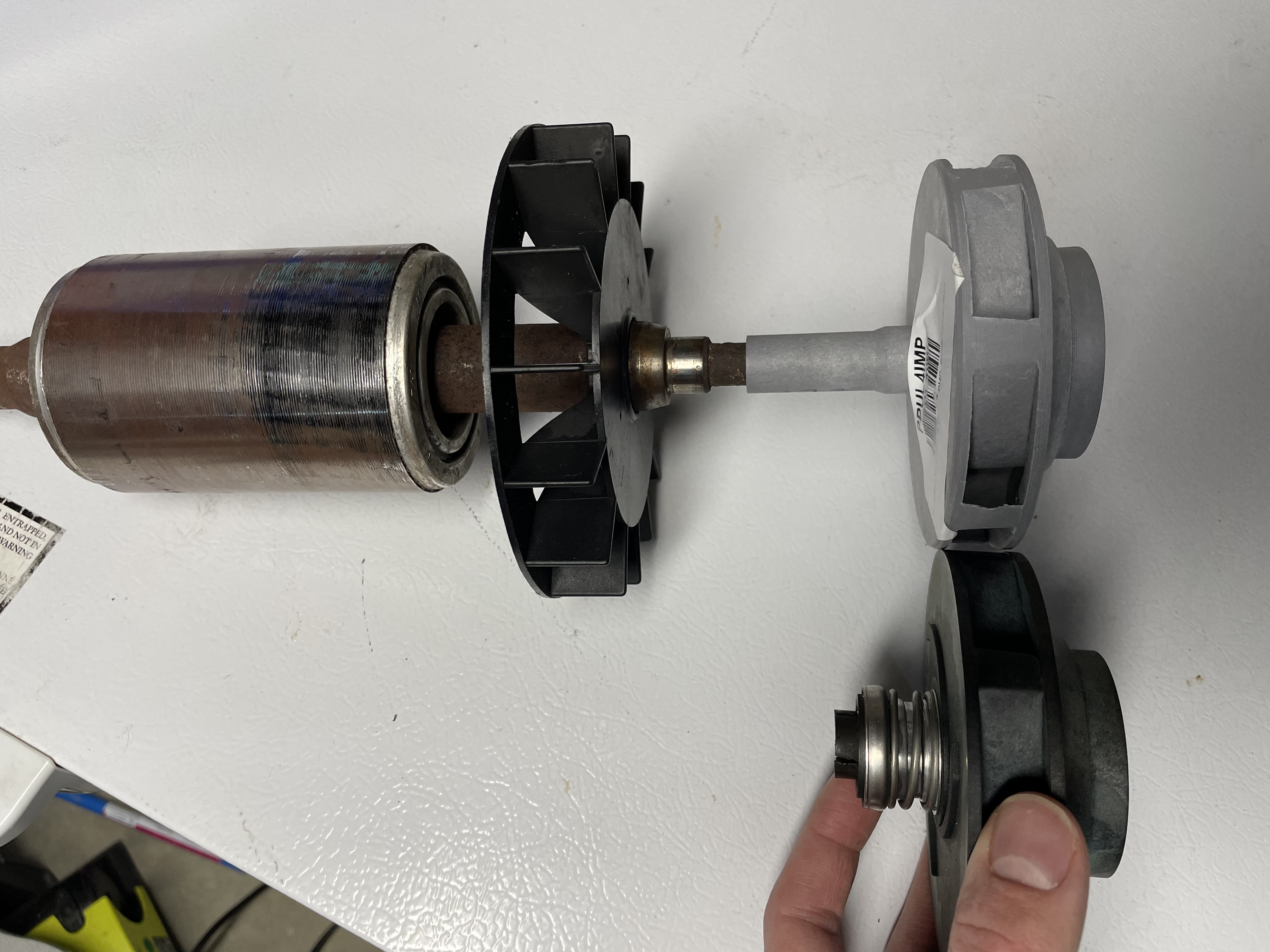

The new impeller has a much longer shaft. It does fit on the pump just fine, and looks identically shaped though it is a 3rd party impeller and not NOS.

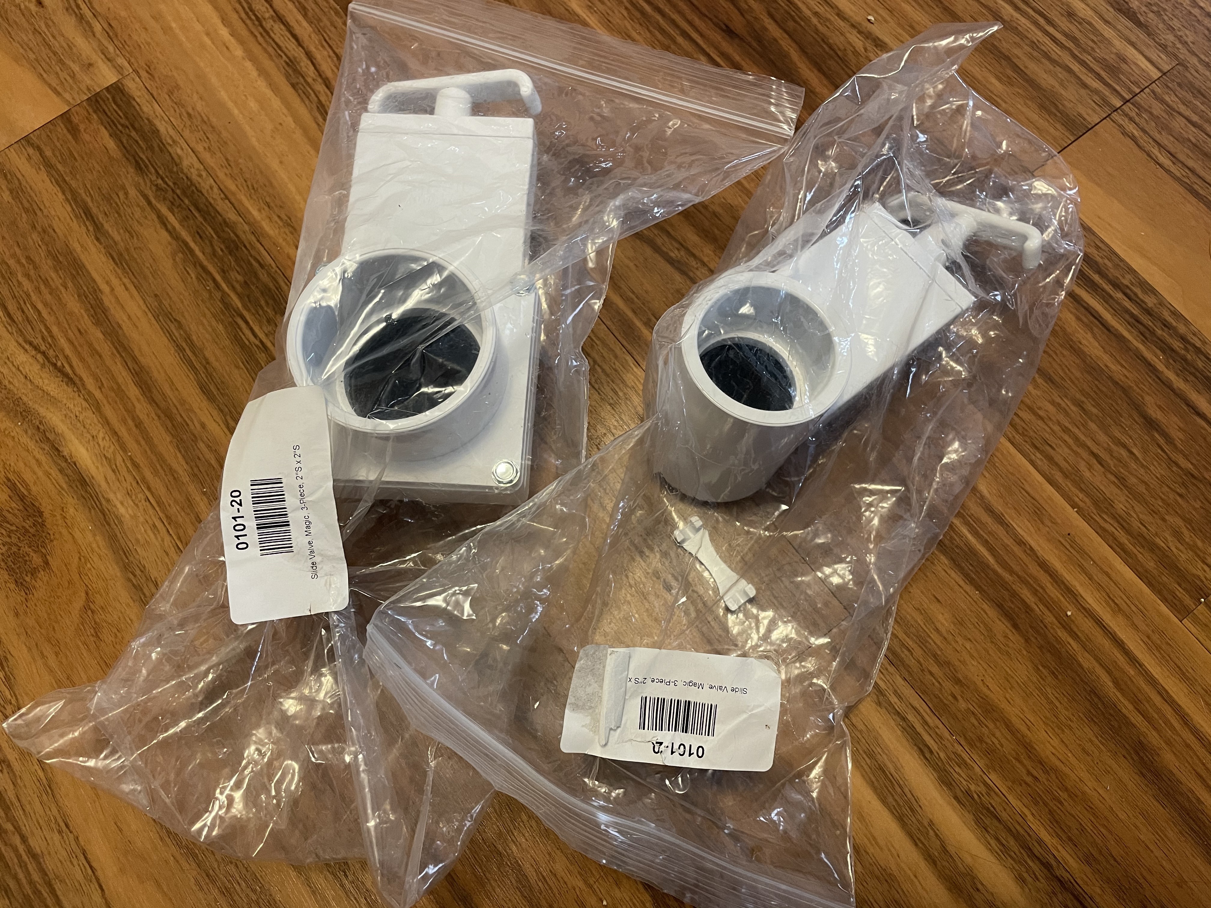

The last thing is I ordered Valterra 3-piece valves. My packing list shows part number for Magic 3-piece valves, which is what the stickers on these bags show. This is an issue as the Magic valves are $17 vs the $24 for Valterra. A bigger issue though is that only one of these is a Magic 2” 3-piece valve. The other is a unibody 1.5” or so valve that got labeled wrong. I contacted them about this too.

I didn’t check my email before posting. 17 minutes after I contacted them I received the following reply:
Hello jseyfert3
I’m not sure this one could have been more screwed up then what you received
I will have the correct valves and O-ring shipped 2nd day air on Monday – we will not want any of the parts you received back
Sorry for the error.
Thank you!
David Pratt
www.spacare.com
Mistakes happen, so it’s how they are corrected that’s important. I’m impressed with the quick reply!
