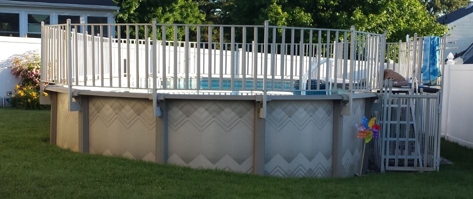

Rust on outside wall pool
the one you can see the yard through is the one that is high up on the wall. I havent pulled away the sand cove to see the rail, should i do that now? The rail on the outside of the pool looks ok.

It looks like surface rust from 3 states away, and primer will only help.
How's the bottom rail ? Sometimes they catch the water running down the wall and take the worst of it.

Yes. You want to know now, and not later after the work has been done. The outside being clean is a good omen.

Definitely give everything thing a good look over while you have the opportunity - a liner can last 10-15 years, that’s a long time to be worried your pool might burst unexpectedly. If you see compromised parts of the bottom of the wall you’ll need to call it.
Fwiw 16 years is a good run for an above ground pool.
At 16 years old and with that rust I'd think real hard about replacing the whole thing, especially if you need a new liner anyway. I had to make the same decision about 18 months ago, but my rust spots were along the bottom rail and very visible from the outside so much higher 'burst risk' than I think you may be facing if it's really just that one bad spot up kinda high.
Others have you covered it so I'm just reiterating to take a real close look at the inside behind the cove and see what you are dealing with.
And watching a few videos of AGPs bursting may influence your decision too!
Have you pulled the rest of the liner off the wall to see what kind of shape it is in? Outside my pool wall only showed rust in a relatively small area. The inside of the wall was much worse all the way around. There is a link to the demise of my pool in my signature.
Patching the rust will probably gain you a couple more years. As part of your descision making process, look at what is directly behind that damaged section of pool wall and what could possibly be damaged if that wall gives way. 11,000 gallons of water released all at once can do some damage to your or your neighbor's property depending on proximity.
