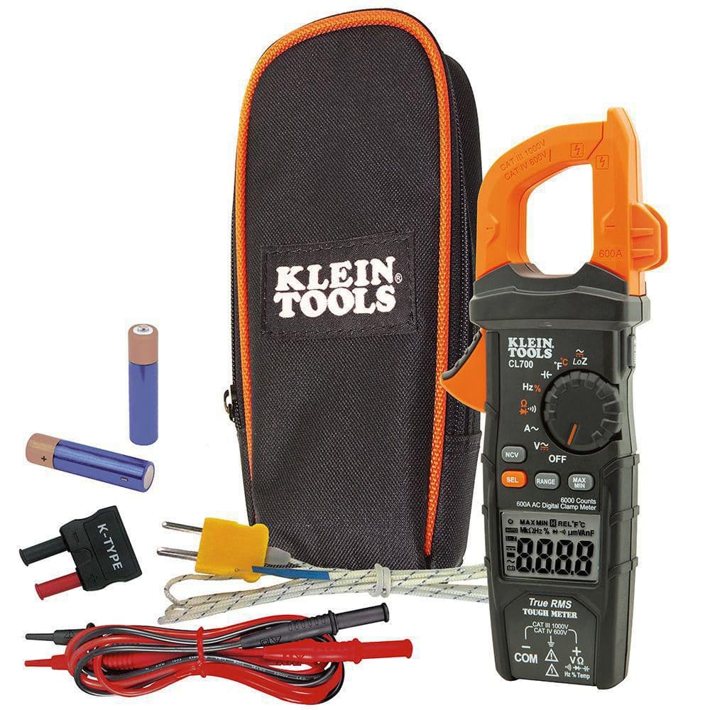

Do you have a recommendation for a multimeter to buy?
I will check the breaker panel and report back.
No just get a basic digital one. Homedepot may have a better quality then walmart. Amazon has one for $12 as an example. Your not super concerned if you read 221v instead of 220.
Don't get a cheap multimeter. You want one that says "True RMS".
Cheap multimeters use averaging and rely on the voltage being a clean sine wave.
Certain equipment, like a variable speed pump can distort the sine wave, which can cause a cheap multimeter to be inaccurate.

That should work. The CL600 model is a little bit less expensive and should be ok.
