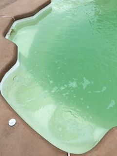

Thank you Kim! I had no idea that is how you work this filter. I think there is a lot of sand in the pool - guessing that is from the filter? Not sure how it got from filter to pool though. The person who had this house and put in the pool, had a lot of "top notch" things that the pool company sold him on he told me - like a fiberoptic light (which I don't know how to turn on), another "port" if you will, that looks like a skimmer but it isn't. It's for if there is a problem under the pool, that is how they'd access it. He also said that he has the filter that is purposely too big for this pool. I'm trying to upload a photo to show you the pump. He said the pool also self levels itself. I'm not sure how to take it apart but I can look at it in the daylight and see. I'll look at your article. Thank you thank you.

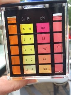

You have made the comments that at one point you added over 27 gallons of bleach to your pool. That's a TON of chlorine for an 11k gallon pool. I'd like to see about where you are FC wise, as you could be toying with damaging your pool. Please do a FC test using the K1000 (little blue box in the TF100 kit) and take as clear of a photo of it as you can. Report back ASAP with the description of what you see.

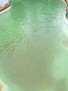

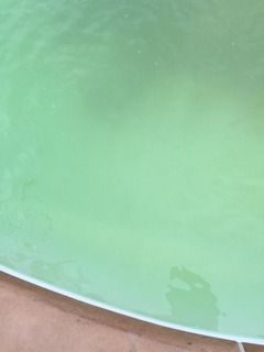

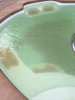

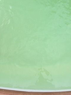

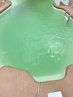

Thanks for the photos Jen. Do you have a vacuume you could get the stuff on the bottom vacuumed up?
Will be watching for you to post the picture of your test results in the blue box. Just do the. Chlorine test and post the pic. Don't worry about PH test.
I can't tell for sure if this is an orange or brownish. Do you see things "floating" in the water?? Either way your FC level is REALLY high. If it's orange I'd guess your FC levels are between 15-30 where brown will ballpark you over 30. These MUST come down to avoid damage to your pool. What is your current CYA level? This will help us determine just how aggressive you need to be to lower these levels.
I don't see anything floating in the water. Just the sand at the bottom.
