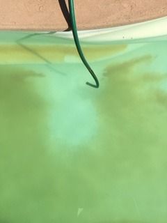

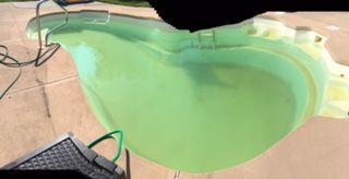

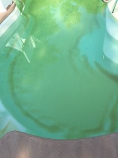

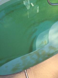

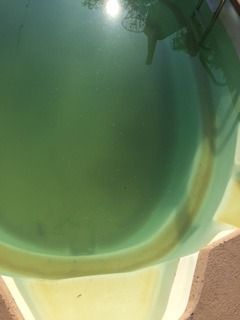

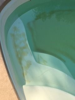

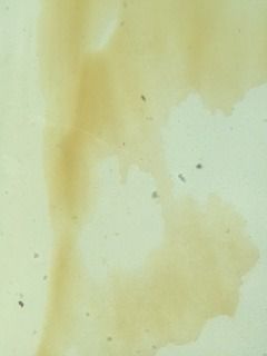

Pool is almost filled up! Now, there is still this brown stuff that is at the bottom of the pool. See photos. It is not sand as I originally thought. I don't know what it is. Is it mustard algae? I brushed the pool throughout the night and the brown stuff re-appeared in the SAME spots - I know this 100% b/c even in the shallow end, you will see in the photo, there is one spot that doesn't have it. Same pattern. LMK what you think. Here are the photos.
http://i725.photobucket.com/albums/ww258/jenmazz/IMG_7591_zps07qppumd.jpg
http://i725.photobucket.com/albums/ww258/jenmazz/IMG_7590_zpshu15pffk.jpg
http://i725.photobucket.com/albums/ww258/jenmazz/IMG_7589_zpsfdhjjvnz.jpg
http://i725.photobucket.com/albums/ww258/jenmazz/IMG_7588_zpshhrphxbg.jpg
BTW, I did find out through reading that "The other unique thing about low calcium is that it can make the water have a slight green tint to it. We usually see this in pools where the calcium level is below 100ppm. The water will be clear, it just will have a green tint and shocking does not clear the green tint." This is what happened when the pool was first opened - it was clear but a tint of green (plus a slight odor of some sort). Then I added calcium hardness like the pool store said b/c Calcium level was at zero......and shock b/c free & total Cl were zero - then green right away (like w/in 20 min)
Thank you!!!!
There's multiple things it "could" be, however Slamming the pool is our starting point for now. If you can, use your K2006 and post these results,

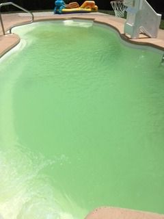

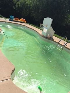

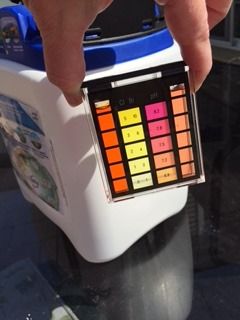

Okay, here are photos and the counts.... (I'm getting excited b/c I see clear water)
Total Alk: 150 ppm (15 drops to turn red)
Calcium Hardness - at 35 drops was a purple/blue - at 40 drops it was more blue - 400 ppm
PH: 7.2
Chlorine - can't do yet - waiting on 0871 reagent
But Cl with the blue box test kit is still orange

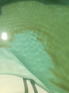

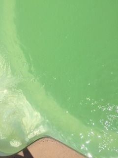

Also, the hose water - it moves the brown stuff with great ease - hence the spot under the hose being clear - SO, where the hose was during the night, caused the pattern in the shallow end. And with all the vacuuming & backwashing previously still didn't get it out of pool.
http://s725.photobucket.com/user/jenmazz/media/IMG_7598_zpsv1ppmmex.jpg.html?filters[user]=143333590&filters[recent]=1&sort=1&o=0
http://i725.photobucket.com/albums/ww258/jenmazz/IMG_7597_zps73nhnxza.jpg
http://i725.photobucket.com/albums/ww258/jenmazz/IMG_7596_zpsrml4fl56.jpg
http://i725.photobucket.com/albums/ww258/jenmazz/IMG_7595_zps4s4yuhab.jpg
http://i725.photobucket.com/albums/ww258/jenmazz/IMG_7594_zpsobazsmep.jpg
http://i725.photobucket.com/albums/ww258/jenmazz/IMG_7593_zpsdzgnreee.jpg
http://i725.photobucket.com/albums/ww258/jenmazz/IMG_7592_zpsokhgp5al.jpg
if you can, try to pickup some of the brownish stuff. What does it feel like?
This photo is very promising as we can now clearly see the bottom of the pool. :cool:
One suggestion to try is to use either a skimmer sock, or pantyhose to try to catch whatever that is floating in the water. I'm still holding off making any more suggestions at this point until we can get another solid CYA and FC result from you kit. You've got enough chlorine in the water it appears to hold off any further algae outbreaks so for now I'd just brush and vacuum as much as you can.
