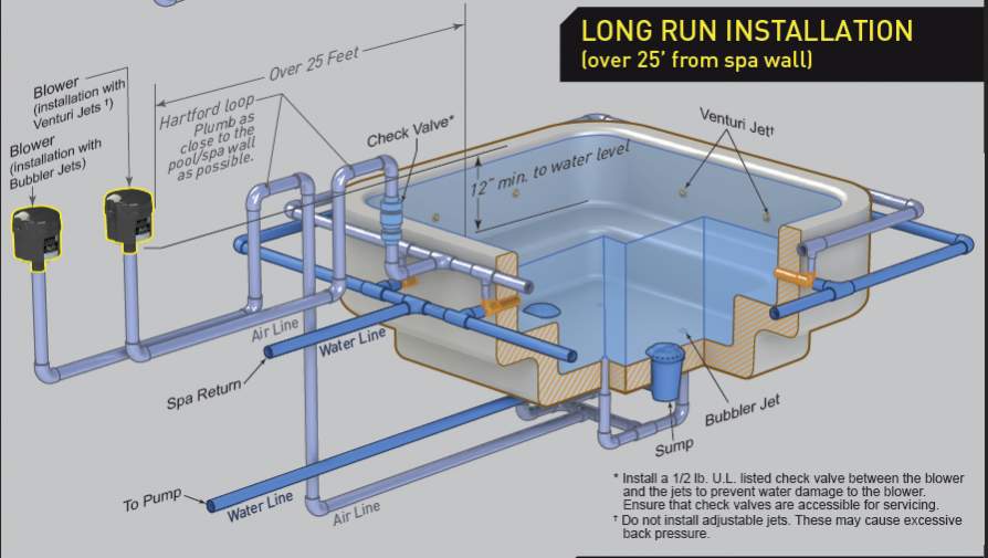

I have never seen floor bubbles in pools is that something which can be done with a blower?
Yes but it is mostly cosmetic rather than therapeutic. Here is a picture showing both:

My spa has 6 jets and no blower. As I mentioned before, venturi jets do not need a blower IF the plumbing is designed properly. That is the whole point of the venturi. It creates suction from the water passing through it which clears the air lines and then sucks in air. The problem comes in with long air lines that are sloped downward from the spa. If those fill up with water, they become very hard to clear without a blower. That is why a Hartford loop close to the spa is usually very important. It prevents the air line from filling with water.
