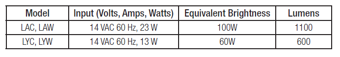

I was researching the lumens on the Hayward lights but did not see this information.
Lumens are in some of the light Installation Manuals.
You are correct. I missed that.

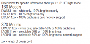

Note that bubbler takes the CrystaLogic 320 or160 lighting. Will you be using the same lights in the pool?
The manual is at https://www.hayward-pool.com/assets...orLogic-crystaLogic-160-320-owners-manual.pdf
From page 1...
Page 2...
From page 1...
I looked at the quote. He is using the colorlogic 320 which looks to be compatible with the bubbler. Do you think I should be looking at something else? Did you have any thoughts on the SR Smith Star Floor? Do the bubblers require a separate pump?
