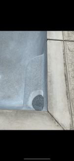

It must of came from the plaster crew when they cleaned up the concrete, water must of got on the step. The water is on the step so I can reach over and sop it up.any idea where the water came from? I would use a cloth towel to sop it up walking in it with sock feet. The acid wash will help take the "stain" away but lets be extra careful and not allow it to start in the first place.
