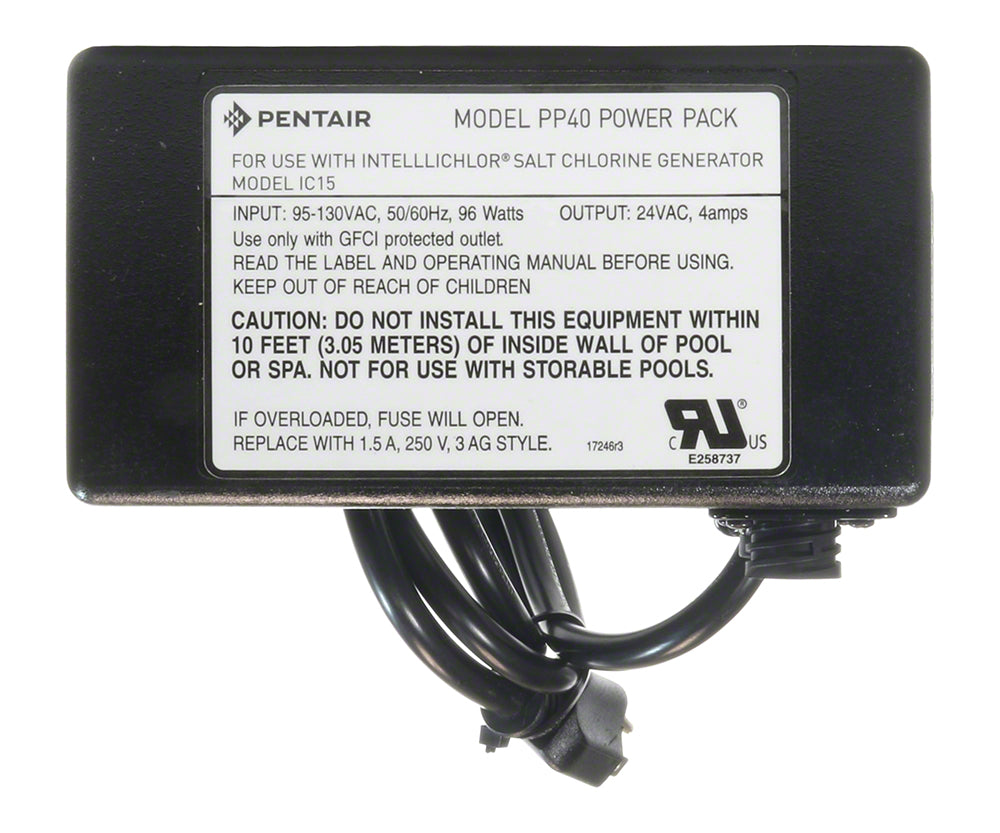

I couldn’t take a second photo. It’s plugged into a black transformer/power supply that is then plugged into AC. Seems like there may be an internal wiring issue.
This is a Pentair External Power Supply for IntelliChlor IC15 Salt Chlorine Generators. This transformer has a 115 Volt Input with a 24 Volt Output. It is designed specifically for Pentair IC15 Salt Chlorine Generators. This is also known as a Model PP40 Pentair Power Pack.
www.poolweb.com
If it looks like this, then it's the wrong power supply. The power supply should be almond/tan, not black.
That power supply outputs AC power as shown on the label, which is incorrect for the ichlor.
