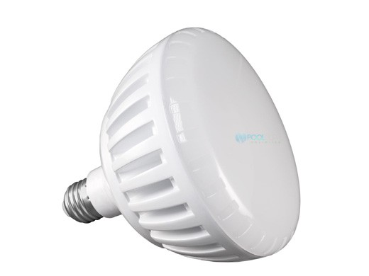

If it is a standard pool light fixture, something like this will last a long time. Its a simple white LED. Not inexpensive, but worth it. Be sure to change any lens gasket at the same time or the light will leak and ruing the bulb and fixture.

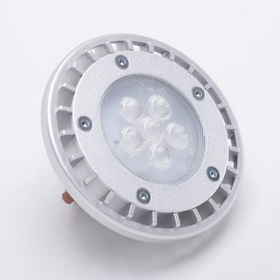

Maybe some of these?
