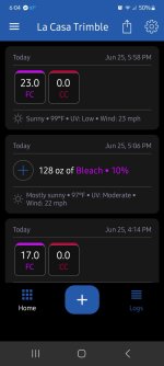

Thanks!! I feel sooooo accomplished! I am attaching the chlorine results I just got which I filled with a chlorine boost. I will not have time for another reading until I get home but I will post. Also, I will have to get more chlorine on the way home so if that link could be found it woukd go a long way in helping me choose bottles. Thanks for all your help. ALL OF YOU!!!

**filled with a**
Should be "followed up with"!! 🙄
