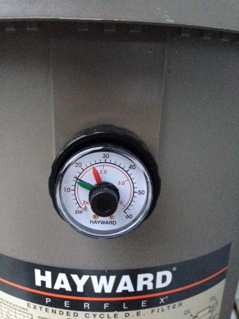

Things have been crazy and haven't had a chance to get back on here... Anyway - new filter and plumbing was done yesterday. I also had them replace the chlorinator. Thought it would be good to have when we go out of town. It was turned up to full when I first looked at it - so I turned it off. First things I noticed, the pump prime was MUCH better and jets were firing really well! They did a decent amount of plumbing - so glad I had them do it. Looks like they kind of simplified things - and, the channel locks are gone. They put a new valve shutoff on and looks good to go.
I'm hoping to take some pics and tests tonight. I'll post and update as soon as I do.
Here's a few of the new filter, chlorinator and plumbing. The is crystal clear and jets are cranking wayyy better! I actually turned the filter off for the night and back on again this morning. I might shoot for that kind of pattern. I'll try and get some pics of pool tonight :)
