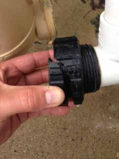

So, filter lid started leaking more and more. Remembered that I forgot lube. So took lid off, sprayed again - starting to wonder if there's too much DE in filter?? Anyway - put the lid back on after lubing. Started spinning the "plastic connector ring" that goes from the filter PVC to the feeder. The ring snapped! Going to need a new connector ring, but I'll need to cut the elbow I guess?
Now I'm stuck with no running filter - and no way to fix it tonight. I'm not even sure what the easiest way of fixing is? UGH!

If you look where I circled in red on your photo you can see that union is already missing and it appears they used a short length of pipe glued into the chlorinator to make the connection. You options to repair the filter are to cut between the chlorinator and the connector on the left and cut on the yellow line on the right, remove the chlorinator and replace it with a piece of straight pipe. You will need a 90 degree elbow, a section of pipe, and some pvc glue. You can also cut off the broken connector and get a new slip union to replace the black connector that broke.
Thanks - that definitely helps.
I don't mind getting rid of the chlorinator, my only hesitation there, is that there's not really any pipe to the left of the chlorinator currently. So I'm not sure how I would join a new straight pipe there? Your second suggestion actually sounds pretty easy. With cutting off the connector - would I only need to cut the connector itself and not the threaded pipe? The connector itself will come off easily. If so, can you possibly show a pic of the type of slip union you mentioned? The threaded piece that the connector ring is on has a lip, which prevents it from sliding (or spinning off). I'm not sure how'd I'd get a new connector ring over that lip though?
I don't know if you have 1.5" or 2" pipe, looks like 1.5", but you could cut it off on the left side right at the 3 way valve and use one of these.
The left side glues inside the pipe, and the right side is the same size as the regular pipe so you can put a coupling on it then go with regular pipe to tie back into the line that comes down to the 90 before the chlorinator.
