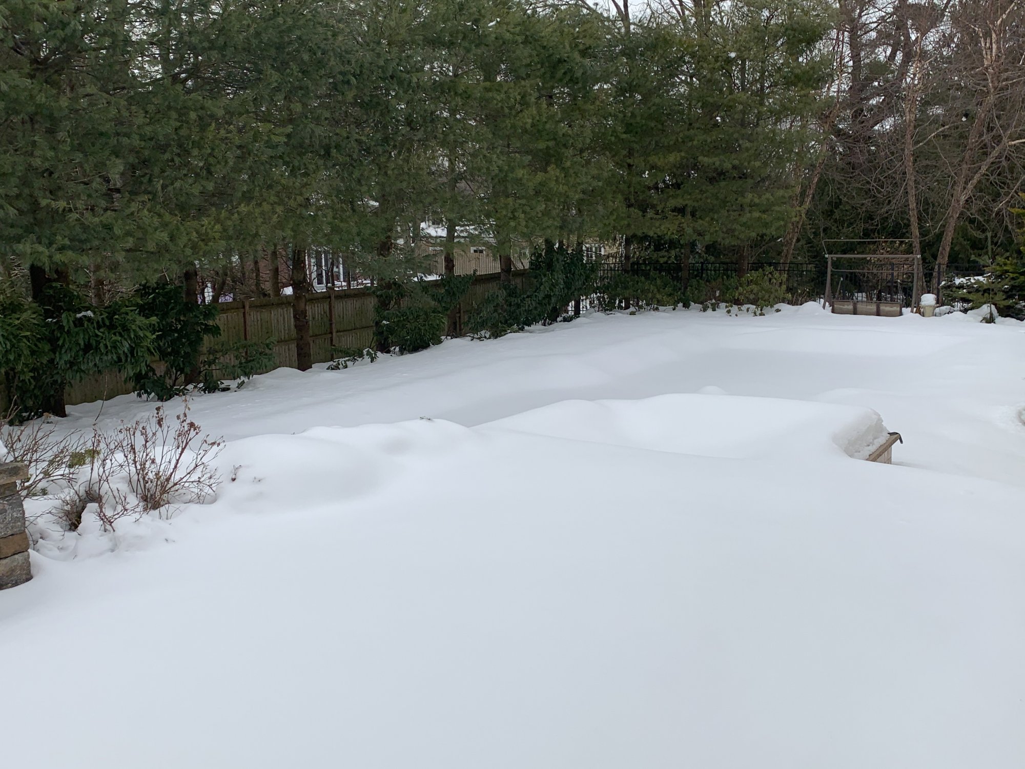

Some winters my pool can look like this:
What pool? :LOL:
I'm in Texas, as you know, and the above picture is really rare. And if it does happen, it is usually unexpected. I'll do some more searching and learning on the forum and see how far I can get.
Yep whole different animal up here in northern climates! My water temp falls well below 60 in October and doesn't climb above 60 again until May. Below 60 algae is not a concern.
Reactions: voidpointer
