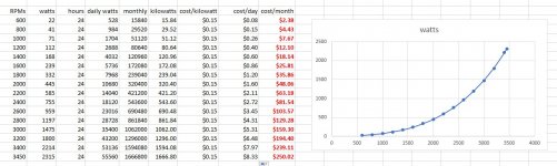

I assume you are not changing your pump runtimes, right? I run mine 24x7 because it is the best way to have consistent SWG chlorine production. You are also trying to dial it in off-season when chlorine depletion/usage is not consistent. Once the season starts it will become way more consistent.
I run my pump from 8AM to 12AM (16 hours). I decided to do that based on how others shared they set up their pump run times. What reason do I have to run for 24 hours? Isn't less run time better for my electricity bill and lifetime of the pump itself?
4 more hours a day at low RPM will be a measly $4 -$5 on the electric bill. So yes, and also good luck ever realizing you saved a little. :)
Pumps are designed to run. Commercial pumps that never shut off run for decades.
Reactions: PoolGate
Low RPMs doesn't use much electric. But yes, you will use less. Running continuously compared to on/off cycles is debatable what reduces life more. Electric motors are really reliable. The electronics less so. Consistency is the main thing and your 16 hours is great.
