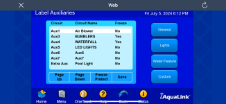

Here’s a picture of that page:
Re-label the auxiliary name “Low Speed” back to the default Aux name, it’s likely Aux2 as that is the one typically used for the two speed relay.
Ok here is mine and do not see it listed…page down does not go anywhere.

Thanks it was the DIP 2 have changed it and now Aux 2 shows in the place of the old low speed.
