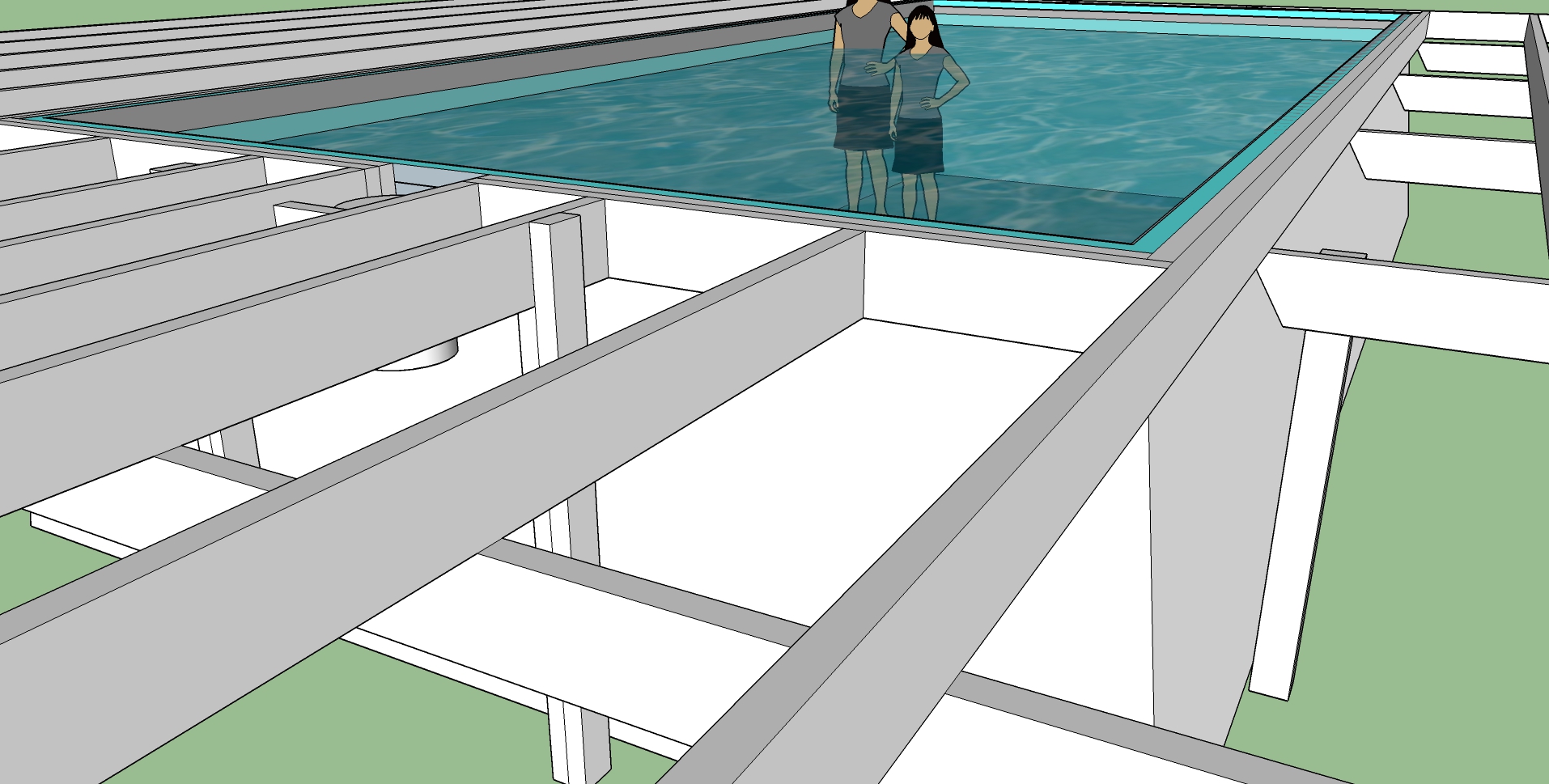

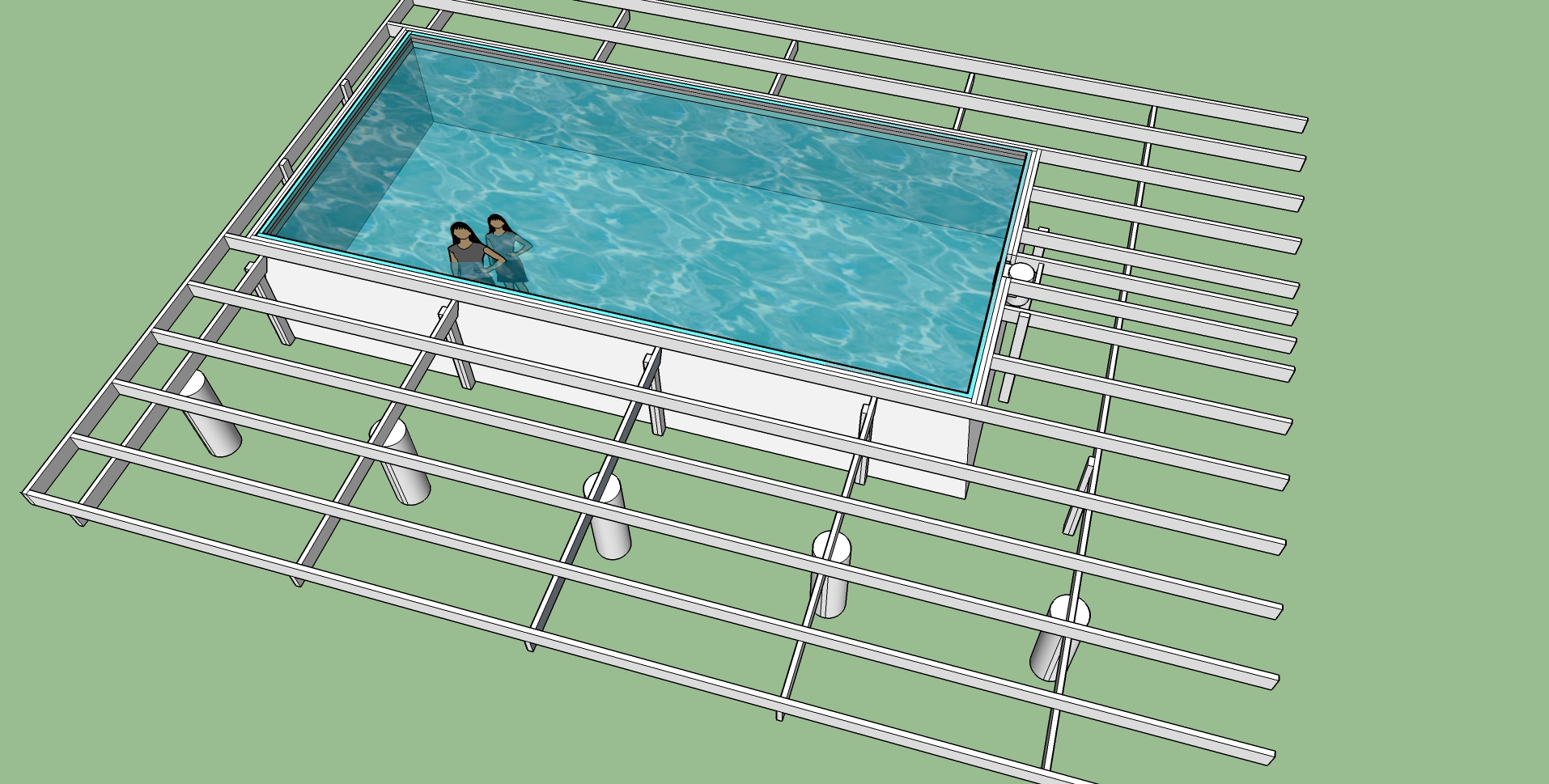

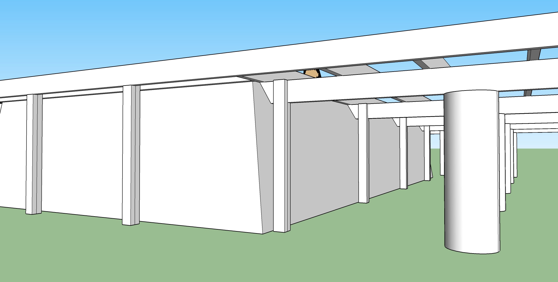

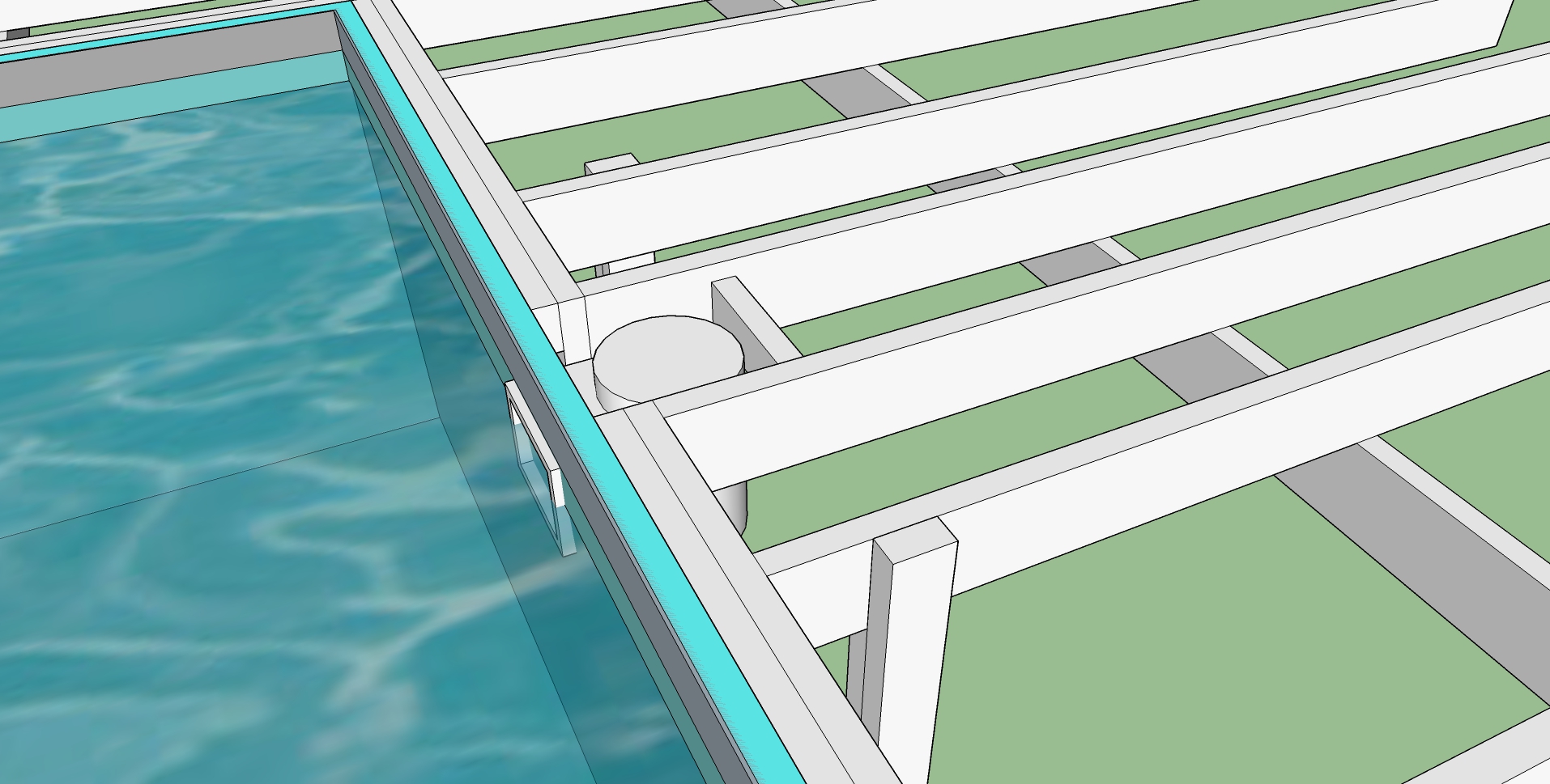

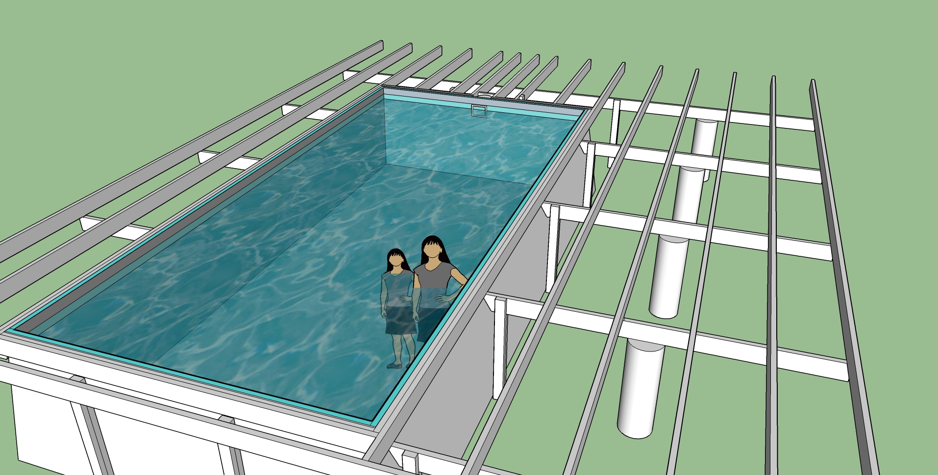

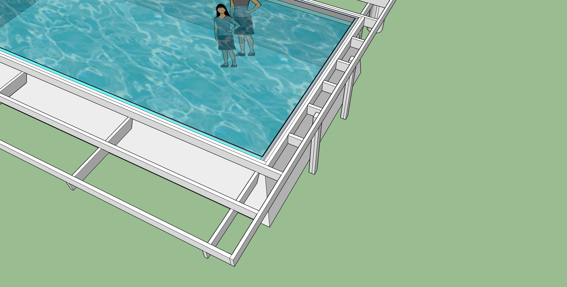

There's going to be a lot of weight on the ledger boards that support the pool wall. In some of your drawings, it appears the ledger boards are resting on the joists. In others, it looks like the ledger may attach to the end of the joists. If that's the case, I suggest using upside-down joist hangers to attach the ledger to the joists and distribute the downward force.
Pic of what I mean: http://photos1.blogger.com/blogger/5337/4135/400/MVC-058F.jpg
Also, the liner will have some support from the compression of the outer ledger, the round pole (with liner around it) and then the inner ledger. I'd suggest filling the pool at least partially before fully tightening the carriage bolts so that the liner can expand/stretch around the wood pole. Otherwise, the liner may tear where it's compressed between the pole and ledger boards if the weight is not allowed to bear on the top of the pole.
