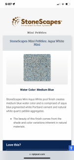

This house is going to kill me. Just now getting done with drywall. Changed out the glass tile with NPT Equinox Midnight. The glass tile just wasn't worth the trouble, in my humble opinion. Picture shows the patio paver (wet and dry), roof tile, pool tile and fireplace fire brick.
My most pressing issue now is the pool finish. The quote includes Florida Stucco Silver Pearl, but I was just quoted for an upgrade to StoneScapes Touch of Glass: Aqua White with 2 extra bags of cobalt blue glass - $7500. Ouch, but I think I will get the medium to dark blue color I want. Thoughts?

Sorry, but this house is going to kill me and I have not posted is such a long time my thread went inactive. Just now getting done with drywall. Changed out the glass tile with NPT Equinox Midnight. The glass tile just wasn't worth the trouble, in my humble opinion. Picture shows the patio paver (wet and dry) which we picked in a 24" x 24", roof tile, pool tile and fireplace fire brick.
