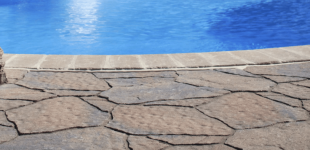

the below is the general plan -- the right is the arbel paver/coping scheme we will use (it matches the front yard that was redone 7 years ago).
